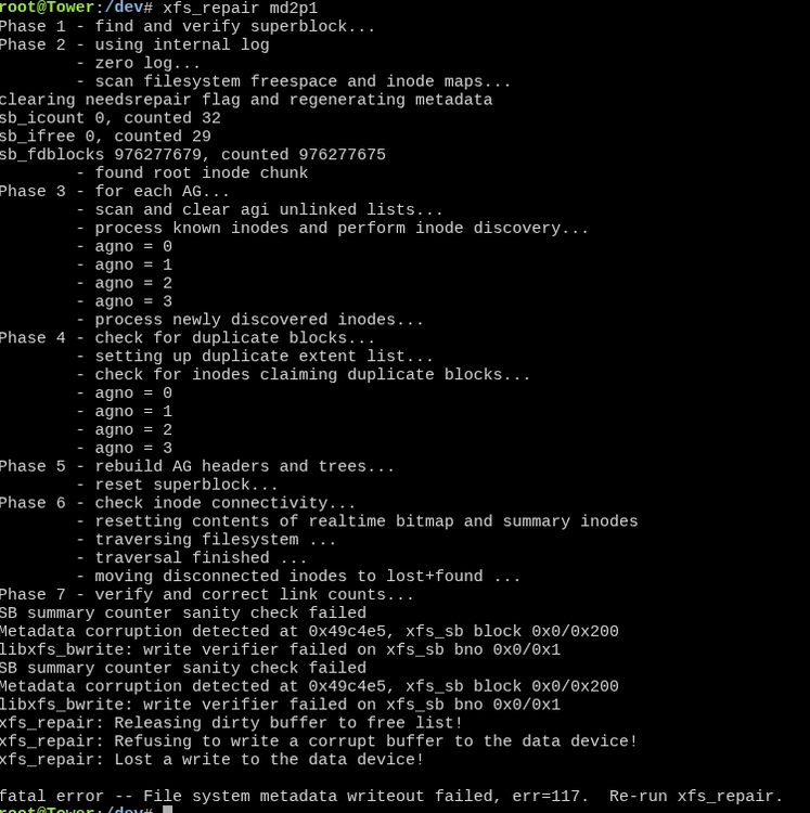

This afternoon I started to get massive BTRFS corruption for the second time, for no known reason on my 2 disk cache pool. I moved everything I could to the array, wiped the pool and restarted the 2 drives as a ZFS RAID1. I then went to restore everything. Was going well, until I got to my HA VM and things went off the rails during the HA restore backup. Now I am getting massive problems trying to start the array on the XFS drives. Ran the fix on the 3 drives, disk 1 seems ok, but disk 2 has the below failure during fix and 3 are currently going through fixes stuck on superblock issues. Those 2 drives wont unencrypt even into maintenance mode. The 2 disk pool is not mounted so I cannot run anything on that at this point. I think I have backups within the last week of most things, but I really dont want to lose any data and/or have to rebuild the server, HAOS etc.

xfs_repair is refusing to write corrupt metadata. If you had other filesystem issues, I would recommend running memtest first.
