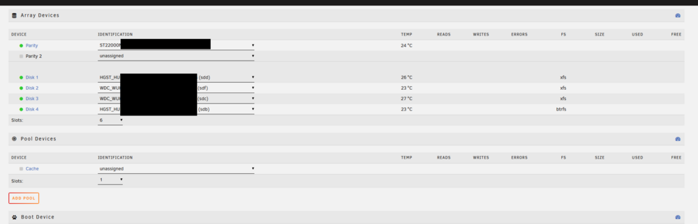

Sometimes it starts up just fine, but as soon as i click anything it stops again and reboots. Sometimes it boots and loses my 2 cache drives - i can reassign it and start up the array, but something still is off.

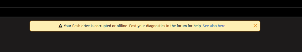

After switching the Mainboard I still ran into the reboots. I then tried to restart with all the hdds disconnected (my cache ssds were still connected) and got greeted with this:
Replacing the flash drive did not yield in betterment but i can boot and run the nas for ages without the drives. Therefore i expect either the sata controller or the hot swap bay of my case to be shot.
Not sure those would be a factor with a USB flash drive; please post new diags.
Was it showing the flash drive errors when the diags were saved? Not seeing any issues.
No it was very unstable, only got the flash backup and swapped sticks. This diag is after the switch but even this takes multiple reboots and luck for it to stay on. Will replace the psu later and use the onboard sata from the new Mainboard instead of the pcie sata controller to do a minimal test. I'll probably even start without the drives first to check if that is stable.
