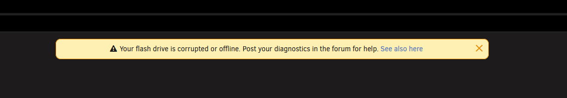

  4. After switching the Mainboard I still ran into the reboots. I then tried to restart with all the hdds disconnected (my cache ssds were still connected) and got greeted with this: Replacing the flash drive did not yield in betterment but i can boot and run the nas for ages without the drives. Therefore i expect either the sata controller or the hot swap bay of my case to be shot.

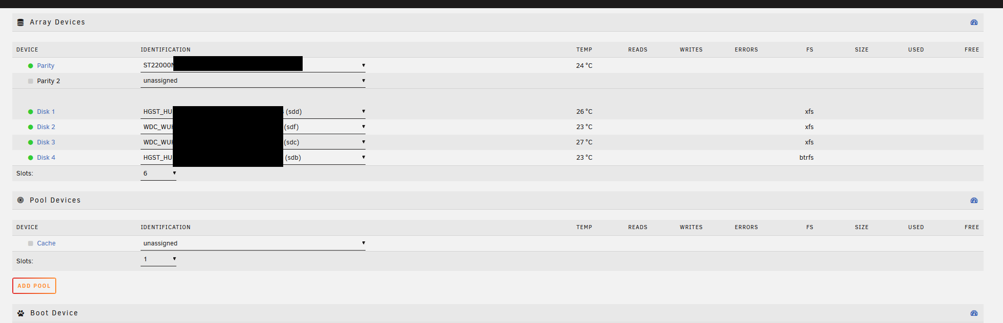

  9. Hi guys, I'm having trouble with my Unraid install. It seems to be in a boot loop ever since i've replaced a broken drive and installed a new parity. It ran fine for over 6 years now. It sometimes boots (and crashes after a minute) and sometimes it boots to bios while starting unraid. Here's what i tried so far. Mem-Test failed, but running it with one stick (tried multiple in multiple slots) does not fix the issue removing XMP Switching USB drives did not fix it Updating to the latest minor version Removing all plugins from the plugins folder Sometimes it starts up just fine, but as soon as i click anything it stops again and reboots. Sometimes it boots and loses my 2 cache drives - i can reassign it and start up the array, but something still is off. Anyone got a clue what i could try? I was able to get diagnostics just now! tower-diagnostics-20260111-1758.zip
