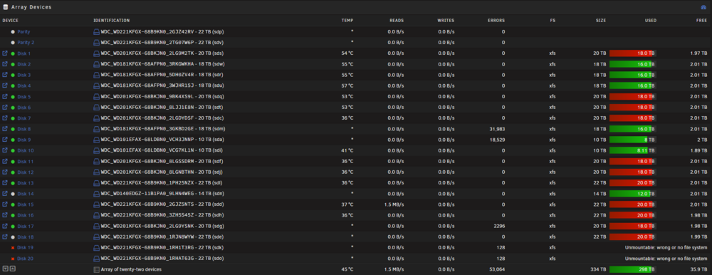

I was out of town for a few weeks and came back to 2 drives 'Device is Disabled, Content Emulated'. Luckily I have 2 parity drives. I ran SMART tests on the drives, everything seems fine. I shutdown my server, I took them out and put them back into their drive bays, booted the server, then stop the server, removed the drives from the array, started the server in maintenance mode, then shutdown the server again, added the drives back into the array, and booted up the server again. The data rebuild started - great.

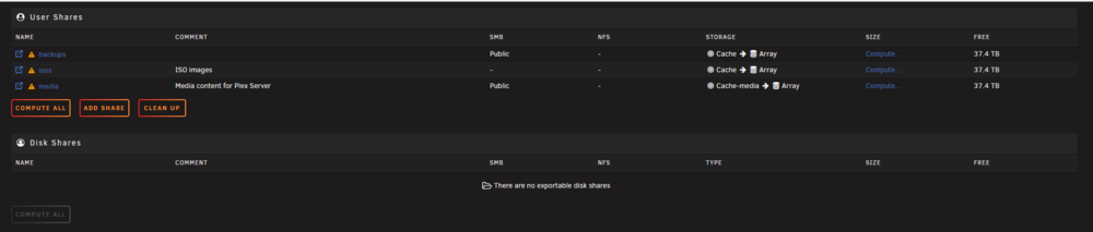

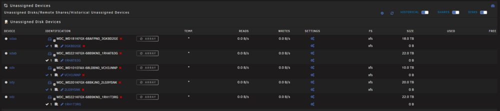

About 40% of the way through - the data rebuild stops/fails. It also kicks out multiple drives into Unassigned Devices. They now show with a * temperature, and throw disk errors during data rebuild. This is for both the drives being rebuilt, parity, and other random drives. Also, my 'appdata' and 'system' shares disappeared.
This whole process has happened 3 times now - and I'm at a loss of what to do to properly rebuild the data disk. What's worse is it takes days to hit the issue due to rebuilding 20TB at 60MB/s. Please help!

Multiple USB devices disconnecting:
Jan 10 22:31:25 LaughingMan kernel: usb 2-2.4.2: USB disconnect, device number 6
Jan 10 22:31:25 LaughingMan kernel: md: disk9 read error, sector=17270386128
Jan 10 22:31:25 LaughingMan kernel: usb 2-2.4.3: USB disconnect, device number 8
Jan 10 22:31:25 LaughingMan kernel: usb 2-2.4.3.1: USB disconnect, device number 13
Jan 10 22:31:26 LaughingMan kernel: md: disk17 read error, sector=17270393040
Jan 10 22:31:26 LaughingMan kernel: md: disk8 read error, sector=17270393040
Jan 10 22:31:26 LaughingMan kernel: usb 2-2.4.3.4: USB disconnect, device number 21
Jan 10 22:31:26 LaughingMan kernel: md: disk20 write error, sector=17270385104
So more disks are disabled, then parity can emulate, as mentioned USB is not recommended, but you can try a different USB port/controller, then post new diags after array start.

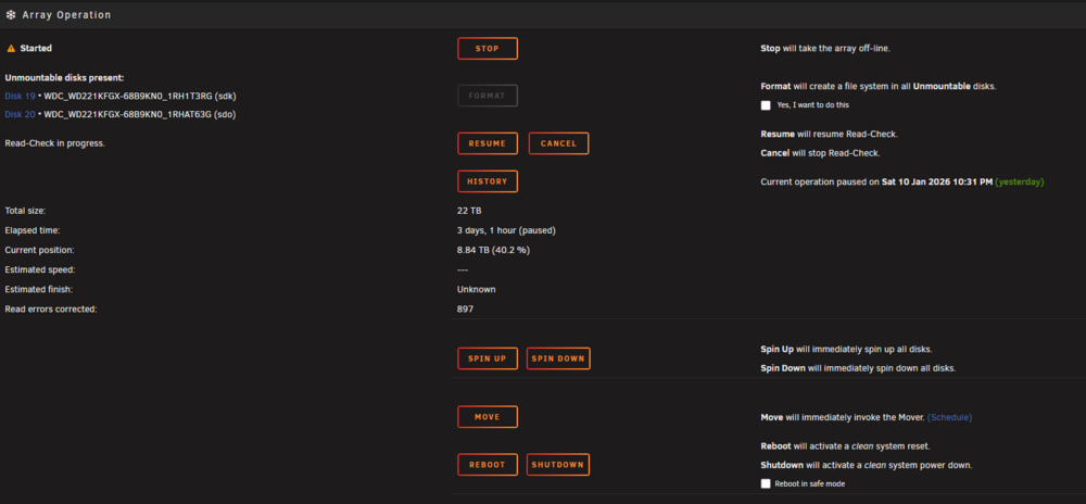

Unfortunately this failed again. It always fails around 35 - 40%. Not sure why or what to do to resolve.

I am a bit confused why the rebuild runs for ~8TB but fails at 30-40% for a 20TB rebuild. Also confused why the USB setup has been working for the past 2 years but is now facing issues.
