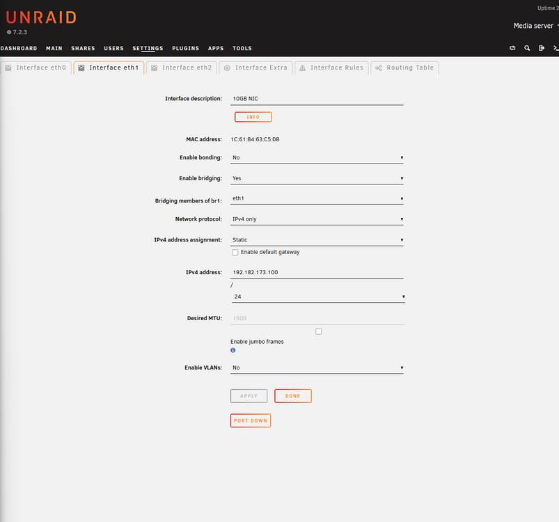

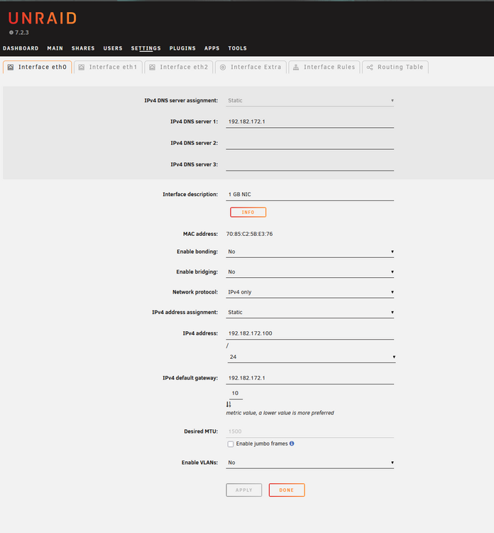

Hello,
i installes a 10 gb NIC in my Unraid computer. Unfortunately it is not resposive from the network (no ping)
below my settings.

You are using a public IP address; you must use a private address, like 192.168.X.X, because of that, we cannot see in the diags if eth1 is on the same subnet as eth0, make sure they are on different ones.
