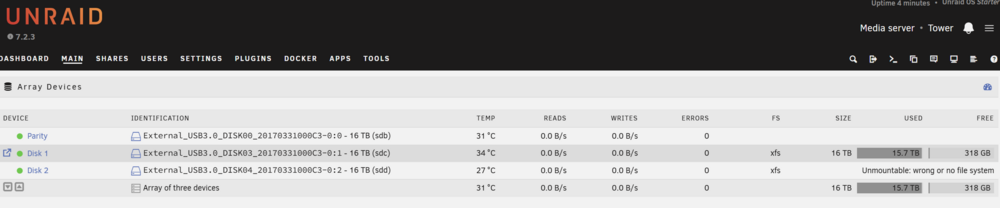

Unmountable: wrong or no file system - what do I do now?
I am getting an "Unmountable: wrong or no file system" error on one of the data disks in my array.
I have tried starting the array in maintenance mode, clicking on Disk 2, and clicking the CHECK button to check the filesystem status. Results are attached to this post.
What should my next steps be? FWIW, I'm not concerned with trying to retain any data from this disk. I had just added it to my array in an attempt to expand my storage and there's nothing on it that needs to be recovered.
Thanks for your help.

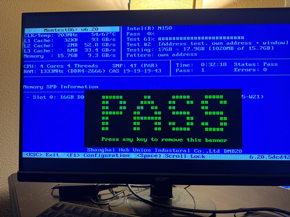

Have you done memtest recently?
Just ran one, appears to be passing.
memtest.jpgra
Let it run for a few hours at least unless it does find an error then you can stop it.
After running Memtest for 15 hours and 11 passes through the test suite, still no errors are found.
Try running xfs_repair again. If it's still unable to repair the filesystem, best bet is using a file recovery app like UFS Explorer; the free trial should show what it can recover.
