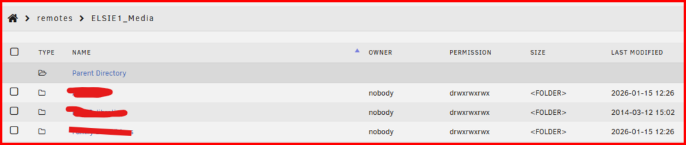

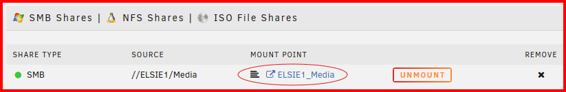

One thing that I see is the you have not clicked on the 'MOUNT' button. Do that and see if the other server mounts on your Unraid server.
When that happens, you should see something like this:
Left-click where I have circled. IT should show something like this:
This is the built-in File Manager for Unraid. We are interested in seeing the owner and permissions on the directories and files. (You are seeing a Share from my first Unraid server which is mounted on my second Unraid server.)
Fank1940 thanks for the reply as you can see this is why i'm pretty sure I have the mount wrong.

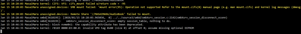

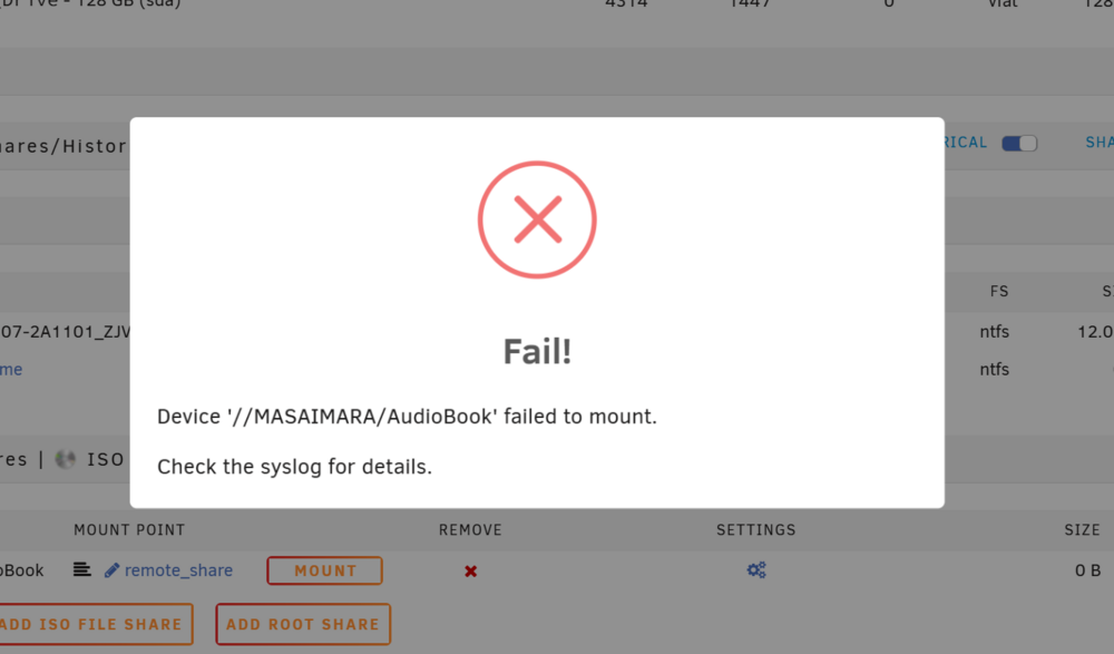

This is what the syslog says: image.png
Any idea what "optional EEPROM" would be missing from? ie where and how to fix?

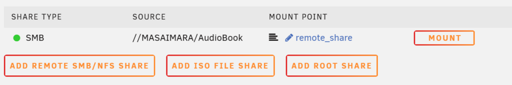

You have to use a valid login to the remote server. (i.e., the same user name and password that you normally used when you logged into that server for the share that you are mounting.)
The biggest issue as mentioned above it the mount was misconfigured: //MASAIMARA/AudioBook -> remote_share. I have removed that and it seems to be working. There are other issues with the Synology remote shares and the UnRaid file browser which I am working to untangle. Thanks for assist.

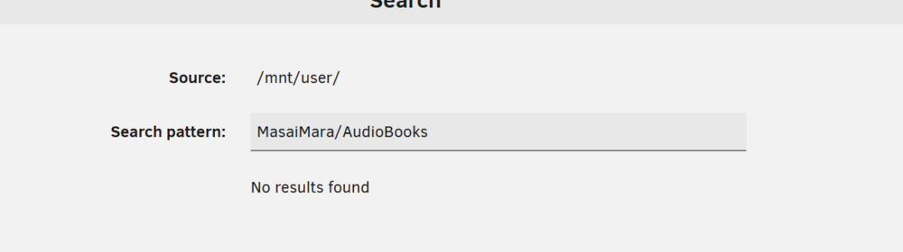

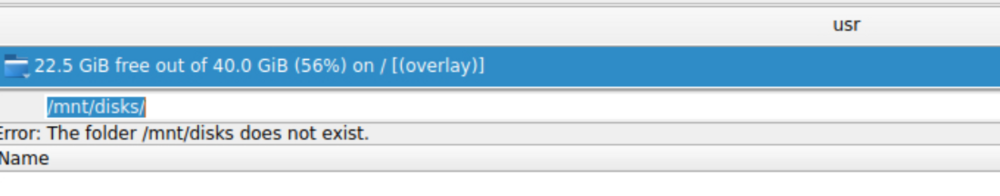

I have tried the above steps many times over the last few weeks and made small progress but have not solved the problem completely. By rebooting server into safe mode I was able to remove the bad remote mounts. Unfortunately Unraid seems to keep a record of old mounts and keeps trying to remount them in spite of this. After refusing the remount of the old mounts I was able to reboot the server into normal mode, I then had to ensure the OS was restarted and the disks remounted. ATT Krusader is reloaded and shows paths to my installed shares. Unfortunately it is still unable to find the path to the local unassigned nvme drive, inspite of the fact that the OS shows the unassigned nvme drive. image.png

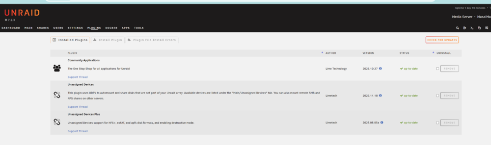

/mnt/disks is created by the Unassigned Devices plugin. If you have removed that plugin, or booted in SAFE mode (no plugins) it will not exist.
trurl, thanks for the input, however as i said above after the safe reboot I reboot into normal mode. As you can see the plugins are present:image.png

Depending on how you have Krusader configured, it might not have access to anything but your user shares, which is the safest configuration for it.
You don't really need Krusader anyway, Unraid V7 has built-in File Manager, and it will let you manage files on shares, disks, pools, unassigned, remotes.

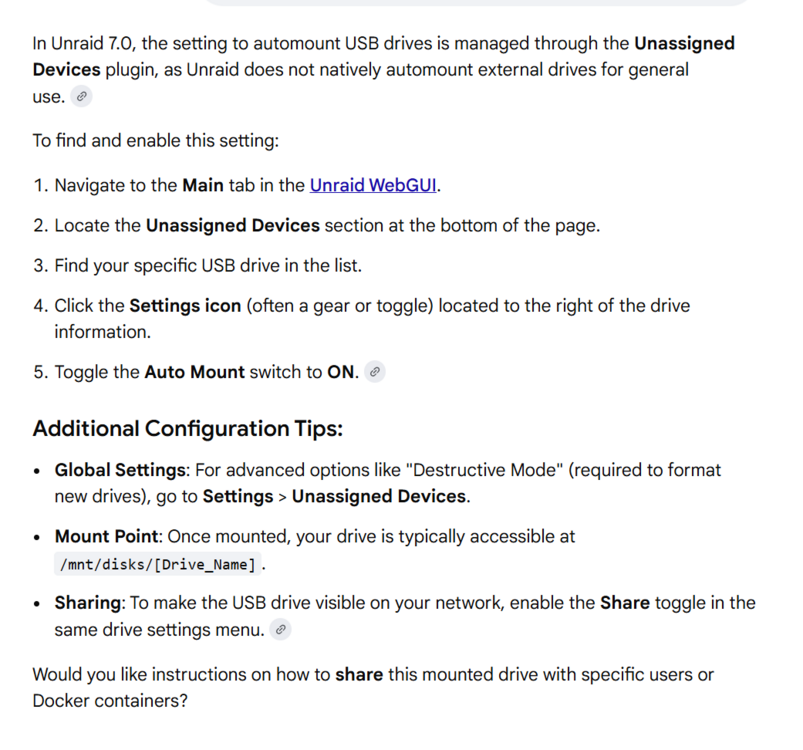

For the moment I seem to have made significant progress by enabling these settings: image.png
What is this screenshot from?

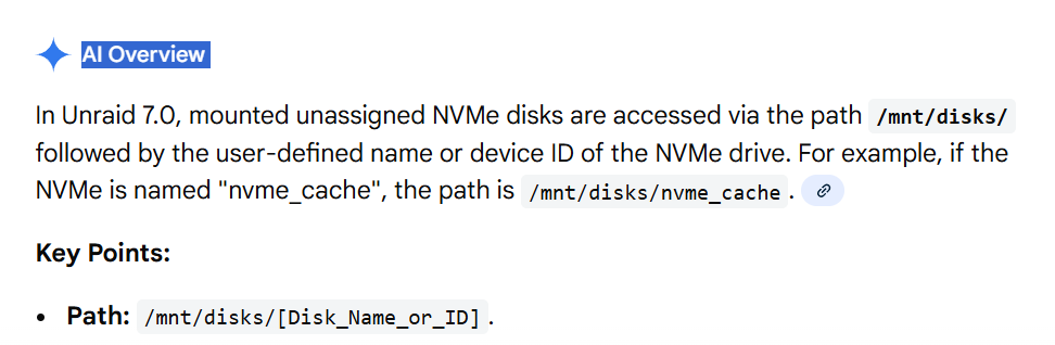

Goggle Gemini
The screenshot with the error message that says /mnt/disks does not exist is from Gemini?
The setting information screen shot is from Gemini.
The error screen shot is from UnRaid.
The error was corrected by: " trurl, thanks for the input, however as i said above after the safe reboot I reboot into normal mode. As you can see the plugins are present:" Which is the Plug-Ins screen shot.
That doesn't look like the Unraid webUI. Is it from a docker maybe?
