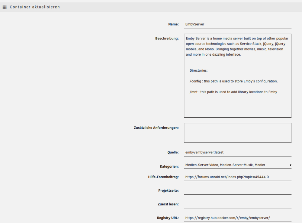

es kommt
<?xml version="1.0"?>
<Container version="2">
  <Name>EmbyServer</Name>
  <Repository>emby/embyserver:latest</Repository>
  <Registry>https://registry.hub.docker.com/r/emby/embyserver/</Registry>
  <Network>br0</Network>
  <MyIP>192.168.178.99</MyIP>
  <Shell>sh</Shell>
  <Privileged>false</Privileged>
  <Support>https://forums.unraid.net/index.php?topic=45444.0</Support>
  <Project/>
  <ReadMe/>
  <Overview>Emby Server is a home media server built on top of other popular open source technologies such as Service Stack, jQuery, jQuery mobile, and Mono. Bringing together movies, music, television and more in one dazzling interface.&#13;
&#13;
&#13;
    Directories:&#13;
&#13;
    /config : this path is used to store Emby's configuration.&#13;
&#13;
    /mnt : this path is used to add library locations to Emby.&#13;
</Overview>
  <Category>MediaServer:Video MediaServer:Music MediaServer:Photos</Category>
  <WebUI>http://[IP]:[PORT:8096]/</WebUI>
  <TemplateURL>https://raw.githubusercontent.com/MediaBrowser/Emby.Build/master/unraid-templates/emby/EmbyServer.xml</TemplateURL>
  <Icon>https://raw.githubusercontent.com/MediaBrowser/Emby.Resources/master/images/Logos/logoicon.png</Icon>
  <ExtraParams/>
  <PostArgs/>
  <CPUset/>
  <DateInstalled>1768973650</DateInstalled>
  <DonateText/>
  <DonateLink/>
  <Requires/>
  <Config Name="Host Port 1" Target="8096" Default="8096" Mode="tcp" Description="" Type="Port" Display="always" Required="true" Mask="false">8096</Config>
  <Config Name="Host Path 1" Target="/config" Default="/mnt/cache/appdata/emby/" Mode="rw" Description="" Type="Path" Display="always" Required="true" Mask="false">/mnt/user/appdata/emby</Config>
  <Config Name="Key 1" Target="UID" Default="2" Mode="" Description="" Type="Variable" Display="always" Required="false" Mask="false">2</Config>
  <Config Name="Key 2" Target="GID" Default="2" Mode="" Description="" Type="Variable" Display="always" Required="false" Mask="false">2</Config>
  <Config Name="Key 3" Target="GIDLIST" Default="2" Mode="" Description="" Type="Variable" Display="always" Required="false" Mask="false">2</Config>
  <Config Name="Filme" Target="/Filme" Default="" Mode="rw" Description="" Type="Path" Display="always" Required="false" Mask="false">/mnt/user/Emby_Filme/</Config>
  <TailscaleStateDir/>
</Container>
und
/usr/local/emhttp/plugins/dynamix.docker.manager/scripts/docker create --name='EmbyServer' --net='br0' --ip='192.168.178.99' --pids-limit 2048 -e TZ="Europe/Paris" -e HOST_OS="Unraid" -e HOST_HOSTNAME="Unraid" -e HOST_CONTAINERNAME="EmbyServer" -e 'TCP_PORT_8096'='8096' -e 'UID'='2' -e 'GID'='2' -e 'GIDLIST'='2' -l net.unraid.docker.managed=dockerman -l net.unraid.docker.webui='http://[IP]:[PORT:8096]/' -l net.unraid.docker.icon='https://raw.githubusercontent.com/MediaBrowser/Emby.Resources/master/images/Logos/logoicon.png' -v '/mnt/user/appdata/emby':'/config':'rw' -v '/mnt/user/Emby_Filme/':'/Filme':'rw' 'emby/embyserver:latest'

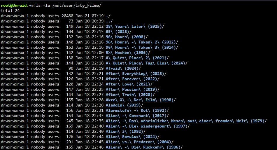

den Pfad gibt es aber schon wirklich ? Unraid Terminal ... ich hab ja gesehen das du hier viel "bastelst" was Shares und co angeht, abenso die UID GID "2" ist sicherlich nicht ganz korrekt, aber anzeigen sollte er zumindest die Ordner
ls -la /mnt/user/Emby_Filme/

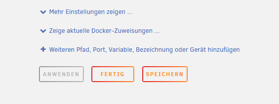

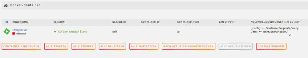

scheinbar nimmmt der Docker nichts an steht auch in der Volumen Zuordnung noch die alten Pfade die inzwische ja gelöscht wurden
edit
sorry bin ein trottel 😜
bin einfach nur auf Speichern gegangen , nicht voher auf anwenden
heute wieder einiges gelernt
Danke
Edited by Soletti

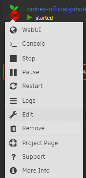

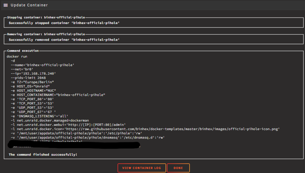

es hatte mich hier schon gewundert, wie Du zu dieser Art Ausgabe gekommen bist.....

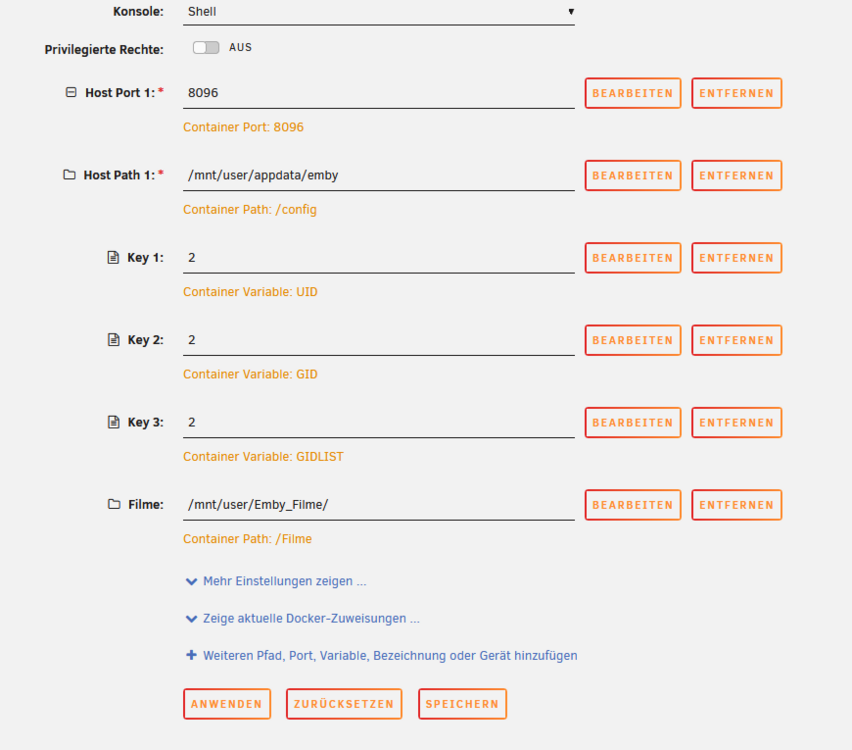

Wenn man einen docker editieren möchte, klickt man ihn doch an und wählt "Edit":
dann steht da ganz unten erstmal nur "done=fertig":
wenn man die Konfig ändert, wird daraus die Nachfrage bzgl. der Änderungen: "apply=anwenden"/"reset=zurücksetzen":
und nach dem Anwenden steht dann unter dem anschließend ausgeführten "docker run"-kommando mit den ganzen Details (Variablen) das Ergebnis (Successful oder Fehlermeldung) und wieder ein "fertig"-Button.
Wie machst du das?
Wo bist Du jetzt "nur auf Sspeichern gegangen", dass angeblich der richtige "docker run" befehl ausgeführt wurde ohne die Änderungen zu übernehmen?
Und wie kommst Du überhaupt zu obiger XML Ausgabe und dem anschließenden Befehl?
dies Ausgabe kam als ich was geändert habe und noch auf Speichern gedrückt habe
wenn auf Anwenden geht kommt es genau zu deine Ausgabe
Edited by Soletti
ok, meine Frage war: WO kann man denn auf "Speichern" drücken?
sorry, aber ich kenn die deutsche GUI nicht....
Deutsche GUI sagt auch "Anwenden", nicht speichern.
ich war auch irritiert, aber darauf muss man erstmal kommen ;)
sorry ich check's nicht, was hat er denn jetzt gemacht? Ich kann das nicht nachvollziehen....
so schaut es aus wenn ich den Docker öffne und ganz nach unter scrolle
in den Container Emby Einstellungen
Edited by Soletti
