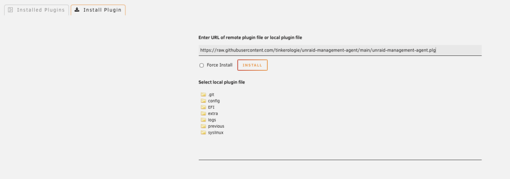

How to Install
The plugin can be installed via Community Applications just search for Unraid Management Agent
