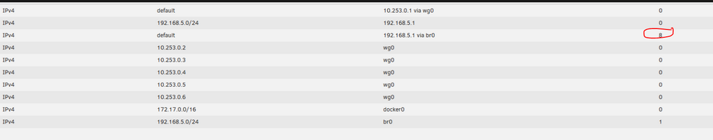

Also post a screenshot from Settings - Network Settings - Routing Table.
Try binding the old nic to vfio. Should make it disappear as far as unRAID is concerned which will make your new nic the default.
Not 100% sure, but I think this could be a problem; try changing that metric to 1, that's the default:

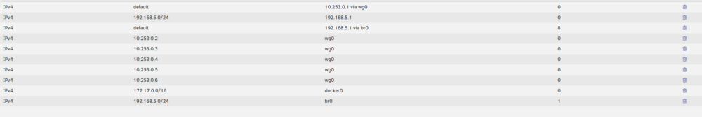

Settings - Network Settings - eth0
The metric is below the default IPv4 gateway field
Tried this, also disabled VPN to simplify the routing table. Still nothing.
