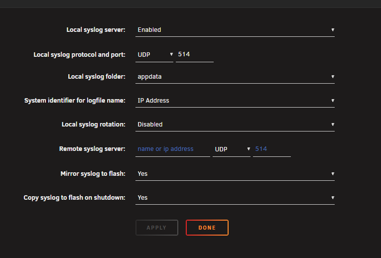

Another crash today. Though for whatever reason, the previous sys log did not show anything from prior to the actual crash. It just shows it starting up. So I have no idea if there were more nginx errors or not. Double checked my Syslog server and it seems setup correctly but still no logs from prior to the crash. just the crash itself. The strange part is, the server comes RIGHT back online. I don't have to go power it up. It crashes, then automatically restarts itself which seems to rule out a hardware issue. The PSU is now brand new and still the same issue.
Post a screenshot of those settings
Don't know why you would think that.
