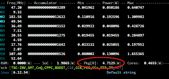

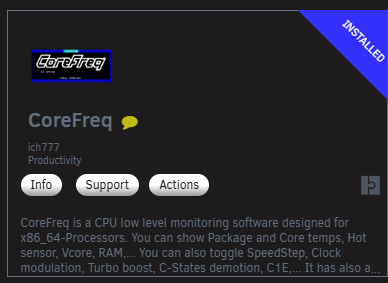

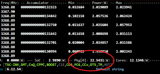

You can use some tools to check CPU / GPU power state. I use Corefreq for CPU always.
Although the reading could be wrong for some CPU, but it still useful to know what power drawing from CPU, for exampe, we would found large power different when apply loading to CPU, it have 4 times differrent.
Edited by Vr2Io
Although the reading could be wrong for some CPU, but it still useful to know what power drawing from CPU, for exampe, we would found large power different when apple loading to CPU, it have 4 times differrent.
I've downloaded an ran it, but I couldn't see anywhere that showed the power draw of the CPU? though, it did show me about 1% utilization..
You can press ESC and got the pull down menu and perform different checking.
