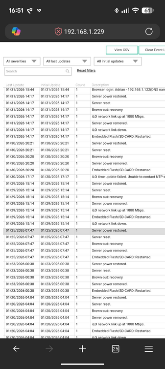

Wait a minnute..
Looking at the ILO event log, i Just noticed entries for Brown out recovery..
Obviously that would reeboot the server...

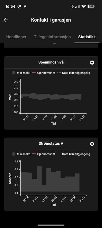

Looking at the log for the power meter the server is atatched to, i se no real drop in power... Sooo. Maby i have a failing powersupply after all. Or at last i need to check the cablinf to the server...

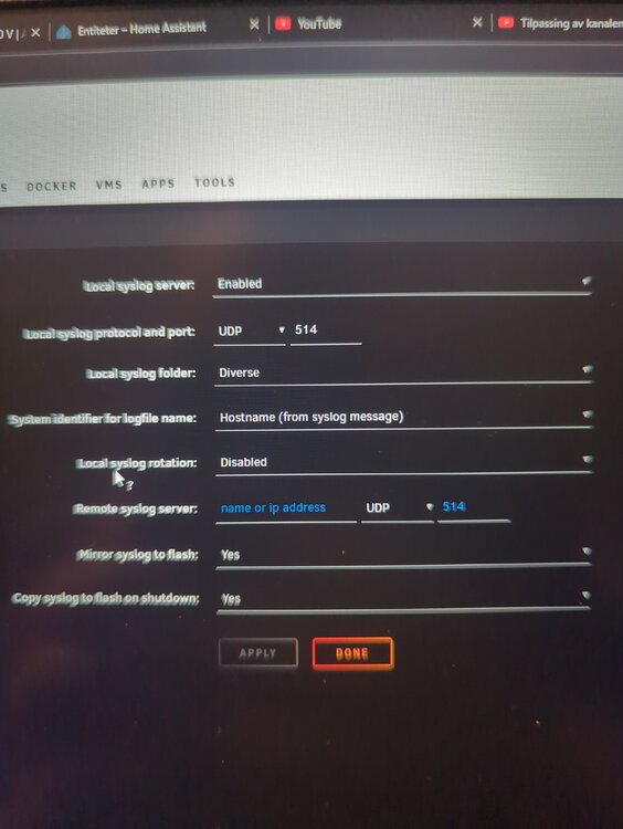

1 hour ago, Adriank said:
Where do i find this log
Where did you tell it to put it?
Post screenshot of your syslog server settings.
Se atatched photo.
But checking the sele tet folder. There is Nothing.
ok, so adding the ip of my server should do it then ?
Edited by Adriank
To create a persistent, reliable copy of your Unraid syslog on your server:
  1. Set Local syslog server to Enabled.
  2. Configure the following options:
    • Local syslog folder: Use a cache-only or preferred share (best for SSDs).
    • Rotation settings: Adjust the file size and number limits.
  3. For best results and to ensure all syslog data (including boot events) is captured, set the Remote syslog server field to your server's own IP address (the "Loopback method"), or the syslog will not be saved to the set share.
    • This ensures syslog events are both stored locally and persist across reboots, without writing to the flash drive.
  4. Click Apply.
    • Logs will be saved to the share you specified.
