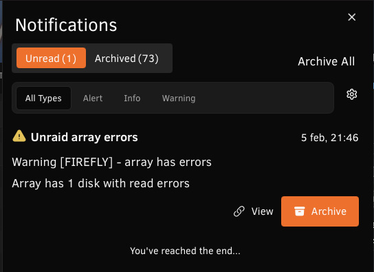

This week a parity check was running on my Unraid server and during this suddenly an error was show that the array had read errors. But when I checked the syslog I see it logs that error for a non-existing disk.
Feb 5 21:45:57 Firefly kernel: md: disk29 read error, sector=29157647288
Feb 5 21:45:57 Firefly kernel: md: disk29 read error, sector=29157647296
Feb 5 21:45:57 Firefly kernel: md: disk29 read error, sector=29157647304
Feb 5 21:45:57 Firefly kernel: md: disk29 read error, sector=29157647312
Is this an error someone has seen before especially with a disk which doesn't exist in my system? Could this due to my HBA going a bit crazy at some time during the parity check? Or maybe some other explanation why this is logged for a disk number not in my system.
