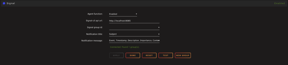

Here is a screenshot of it.

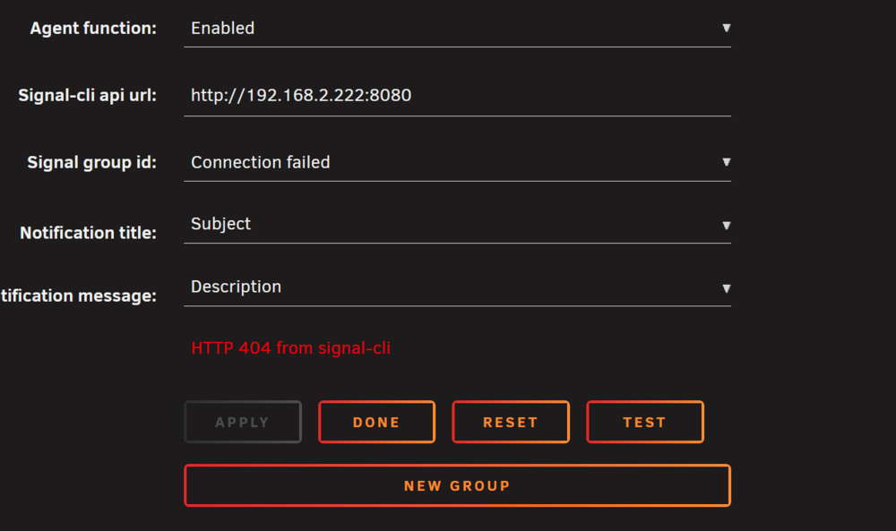

Thanks for this, but I get a 404. I'm running the API on a custom br0 network, but I've tried running it on the normal bridge as well with the same result.
Hey, just now seeing this, sorry for the late reply. Which version of signal CLI docker image are you running?
I'm running the latest of bbernhard/signal-cli-rest-api.
So my readme has the requirement (ghcr.io/asamk/signal-cli with daemon --http mode). But I'm gonna modify the plugin right now to auto-detect which image the container using and auto switch over if possible. I'll report back soon.

Aha, I thought I could use any signal-cli image. Awesome, thanks :)

I made a change, can you try again? Hopefully it works now
Now it installs and connects as long as the signal-cli container is in bridge mode. It will probably work with a custom network if I either enable host access to custom networks or just manually add a route myself. Testing that later, but now I'm gonna test that it works in bridge first. Thanks for the support so far. I'll be back if I see some more issues.
I'll add that fix right now. I just found another bug that doesn't auto detect the port that the container's running on. So I'm fixing that as well.

Awesome. I just added the ability for it to work in host mode, bridge mode, and custom IP address mode. Whenever you get a chance, please test that. And I appreciate your patience.
I've confirmed it works and sends notifications now. But a note for other users with the same macvlan setup as me. If your signal-cli container runs on a custom network with its own IP you either need to go to settings-Docker, disable docker and enable host access to custom networks (this will enable it for all containers). I don't want that, as I want as few containers as possible with access to the host. So if you just want to enable access just for the signal-cli container, you can add this script to the user script plugin and set it to run at array start.
