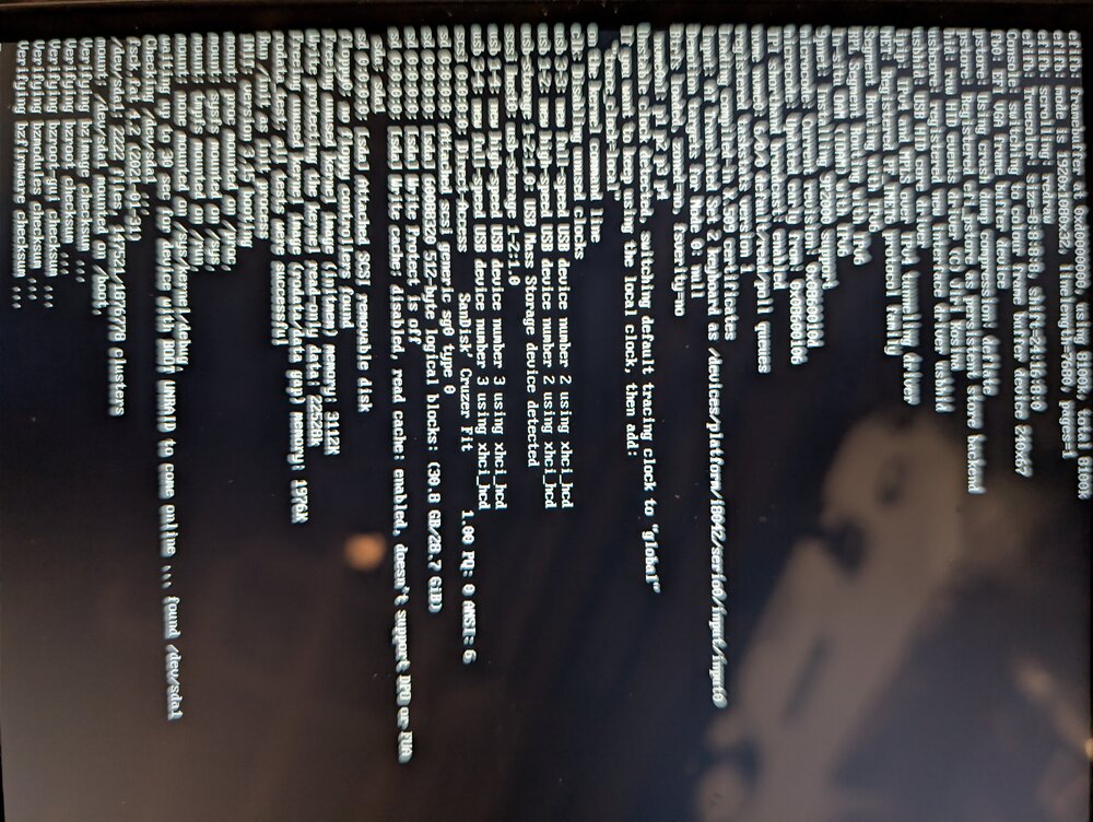

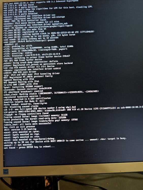

When choosing to start unraid with Gui, I see that it stops after this section:
Waiting up to 30 sec for device with BOOT UNRAID to come online ... Umount: /dev: target is busy.
Umount: /: not mounted.
Not found - press ENTER key to reboot...
