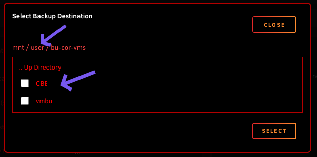

On a related topic, why will it not allow me to select /mnt/user/bu-cor-vms, or any folder directly under /mnt/user but it will allow me to select a folder within /mnt/user/bu-cor-vms?
Edited by The_Holocron
clarification
Just now, The_Holocron said:
On a related topic, why will it not allow me to select /mnt/user/bu-cor-vm, but it will allow me to select a folder within /mnt/user/bu-cor-vm?
this is to prevent the backups going directly to the root of a share, mainly this is a protection for those that use exclusive shares. since unraid doesn't expose this setting to be programmed against (that i know of at least) means i can't make it be allowed for those shares not exclusive and not allowed for those share that are exclusive so i went with the safer option which was to just force to use a subfolder

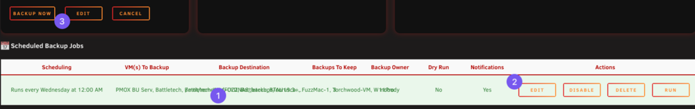

A few other notes:
  1. This is a jumble, particularly if you have multiple VMs selected for backup.
  2. When you click EDIT here, the EDIT button at 3 appears.
  3. This EDIT button, when you click EDIT at 2, seems awkward. Perhaps this should be "SAVE" or "UPDATE"?
Love where this is going.

i like the idea of Update for the edit button at number 3 so i'll change that. for the jumbled mess of a field for number 1 when multiple vms selected i will look into it, i could ellipsis it so when its super long it's cuts off at a certain width where then hovering you can see the full field text

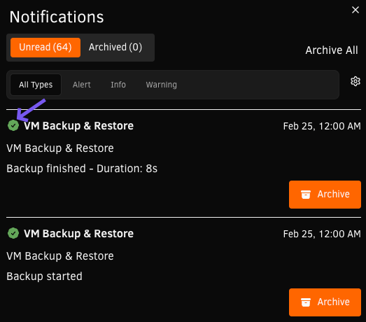

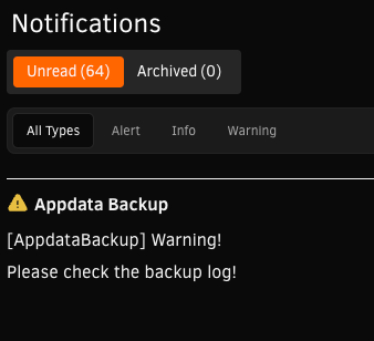

Another small thing. The indicated backup actually had errors (failed completely because of the mount points) upon finish. The notification in the Unraid notifications should ideally indicate that it failed, not just finished, and have the warning icon, similar to the other clip below.
