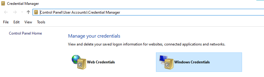

try deleting the entries in Windows Credentials if you have some wrong ones.
If you add a Windows credential .... this is the information you need to supply.
make sure the login and password match up with the UNRAID user information.
the easiest way to get Windows Networking to work is to use your Windows Login username.

Adding my credentials manually seems to have worked. I've never done this before, I've always clicked to access a network resource, waited till the login box opened, then entered my credentials and checking for them to be saved.
For anyone the reads this in the future, it does not need to be specifically "smbuser" as the forum post seems to say. I just added my normal login for my server as a windows credential and it worked.
