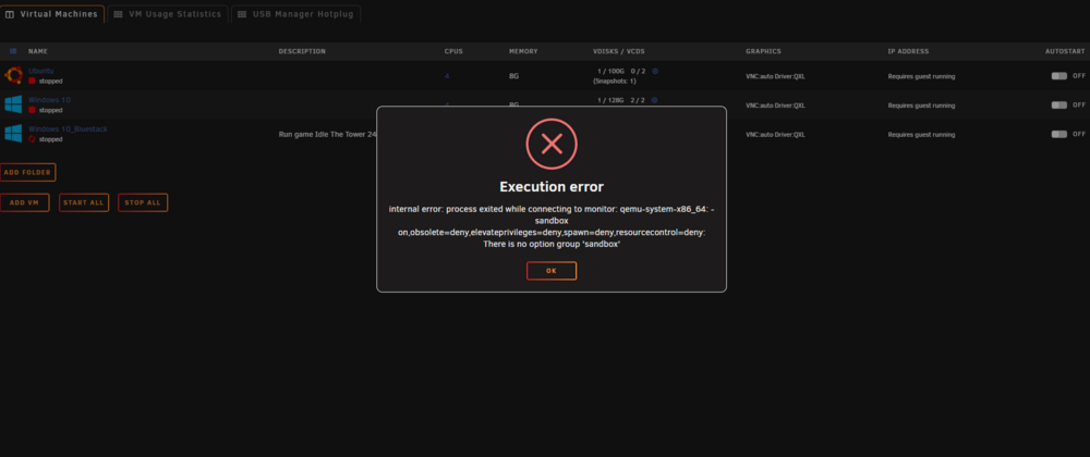

Unraid 7.2.3 got this error in VM
Good days and hi, I want to ask about this error. it's always happen to me. I don't know how to solve it. The error won't show up if I restart my Unraid Server and my VM can start successfully. If I turn off my VM, sometimes the error happens and sometimes it's not. It's not on Windows 10_Bluestack only, it happen to all of my VM when I want to run it. Thank you and sorry for my bad english.

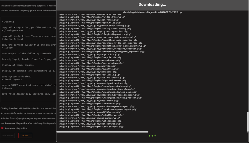

hi, the errors happened again on VM, this time the diagnostics happen to be stuck at the user.scripts.plg. i already uninstall that plugin. then it stuck again on another plugin. like unRAIDServer.plg.
Edited by Hafizuddin_Fauzai

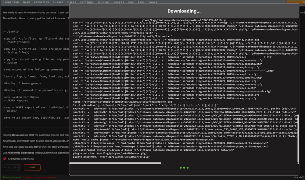

Below is diagnostic files is when I boot into safe mode, I can start the diagnostic.
And the attached pictures is the diagnostic stuck on plugin pluginURL '/var/log/plugins/unRAIDServer.plg'. i want to uninstall the plugin, when i open the plugin tab, it's show no plugin installed.
dintower-safemode-diagnostics-20260221-2355.zip

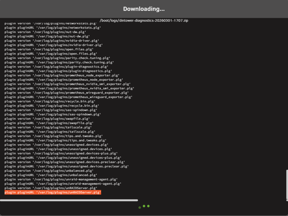

hi, i already change the flash drive. also same problem with the vm and the diagnostic is still stuck at plugin pluginURL '/var/log/plugins/unRAIDServer.plg'
I start the diagnostic in the tools from 17:07 PM Malaysia time. right now it's 18:57 PM. still stuck at that. below is the screenshot.
