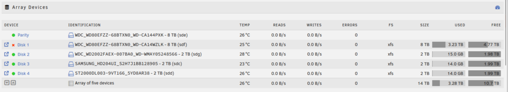

Hello,
I have an unRAID NAS that hasn't burped in 4 years...til today. I'm not super experienced at linux, and, per the unRAID documentation ("Single parity risks: If you have single parity, you're at risk of data loss if another drive fails during the upgrade. Seek advice in forums if this happens.") Now that I see the Disk 1 in the attached, I am seeking advice.
The snapshot does NOT reflect that Disk 1 had 1024 read errors. I panicked when I saw the red X and powered down the NAS so I could do some reading, so the error count got zeroed. I then ran a short SMART self-test and got the following:

SMART for disk1 looks OK. Emulated disk1 is mounted.
Looks like it was a connection problem, and disk2 looks like it is having the same.
All disks are on the same controller. How are these disks powered? Any splitters?
