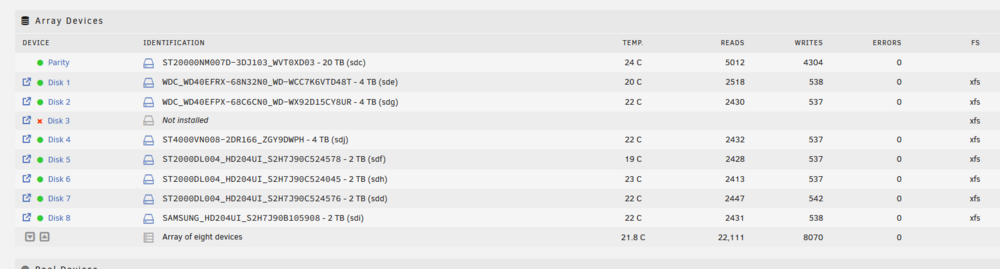

I recently decided to upgrade a lot of my disks, I had 8 (smallish) data disks and a parity.
I upgraded the parity to a 20TB drive and rebuilt, all went well.
I then proceeded to try and swap a data disk, and since unassigning the disk (3), i've lost another disk (7), I think the disk itself has mechnically stopped working.
Which leaves me in this situation, 2 failed disks, but the array is up & running (image), files accessible etc, however, if I stop it, I can't seem to replace the broken disks.
I've also attached the diagnostics file.
Thanks (hugely) in advance, for any guidance whatsoever. n.b. i still have the 2tb disk i unassigned but have the 14tb disk plugged into the system.

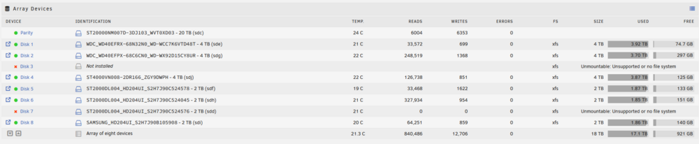

All files can't be accessible since 2 drives are unmountable. You just haven't noticed the missing files yet.
I don't understand how you can have 2 disabled disk with single parity though.
See if you can get disk7 to pass extended self-test.

That's a bug; it was fixed some time ago, but the user is on a very old release.
Best bet here is doing a new config to force enable one of the disks and then try to rebuild the other one.

So, disk7 was the 2nd one to get disabled, it passed the SMART test, and you still have old disk3 intact, correct?
Yes that's correct @JorgeB - one point of note though, disk 3 was unassigned from the array before disk 7 failed (it was being emulated, ready to add the new 14TB drive).

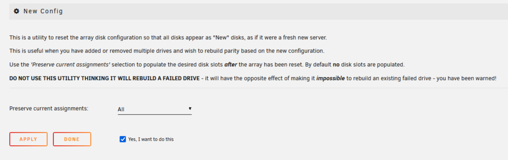

OK, you can try to re-enable disk7to then rebuild disk3, but if the results are not good, you can always revert to the old disk and resync parity instead.
Try this first:
-Tools -> New Config -> Retain current configuration: All -> Apply
-Check all assignments and assign any missing disk(s) if needed, including the new disk3, replacement disk should be same size or larger than the old one
-IMPORTANT - Check both "parity is already valid" and "maintenance mode" and start the array (note that the GUI will still show that data on parity disk(s) will be overwritten, this is normal as it doesn't account for the checkbox, but it won't be as long as it's checked)
-Stop array
-Unassign disk3
-Start array (in normal mode now), and post new diagnostics

Just about to do so, but just wanted to double check Preserve current assignments and 'retain current configuration' mean the same thing?
Appreciate they are very close and wording may have changed in a later build, but i'm extremely risk averse at this stage!
Yep
Emulated disk3 is mounting, and shows about 1.8TiB of data, which I guess is about right, if that's the case, you can rebuild to the new disk, just stop the array, reassign the new disk3, and start the array to begin the rebuild.
