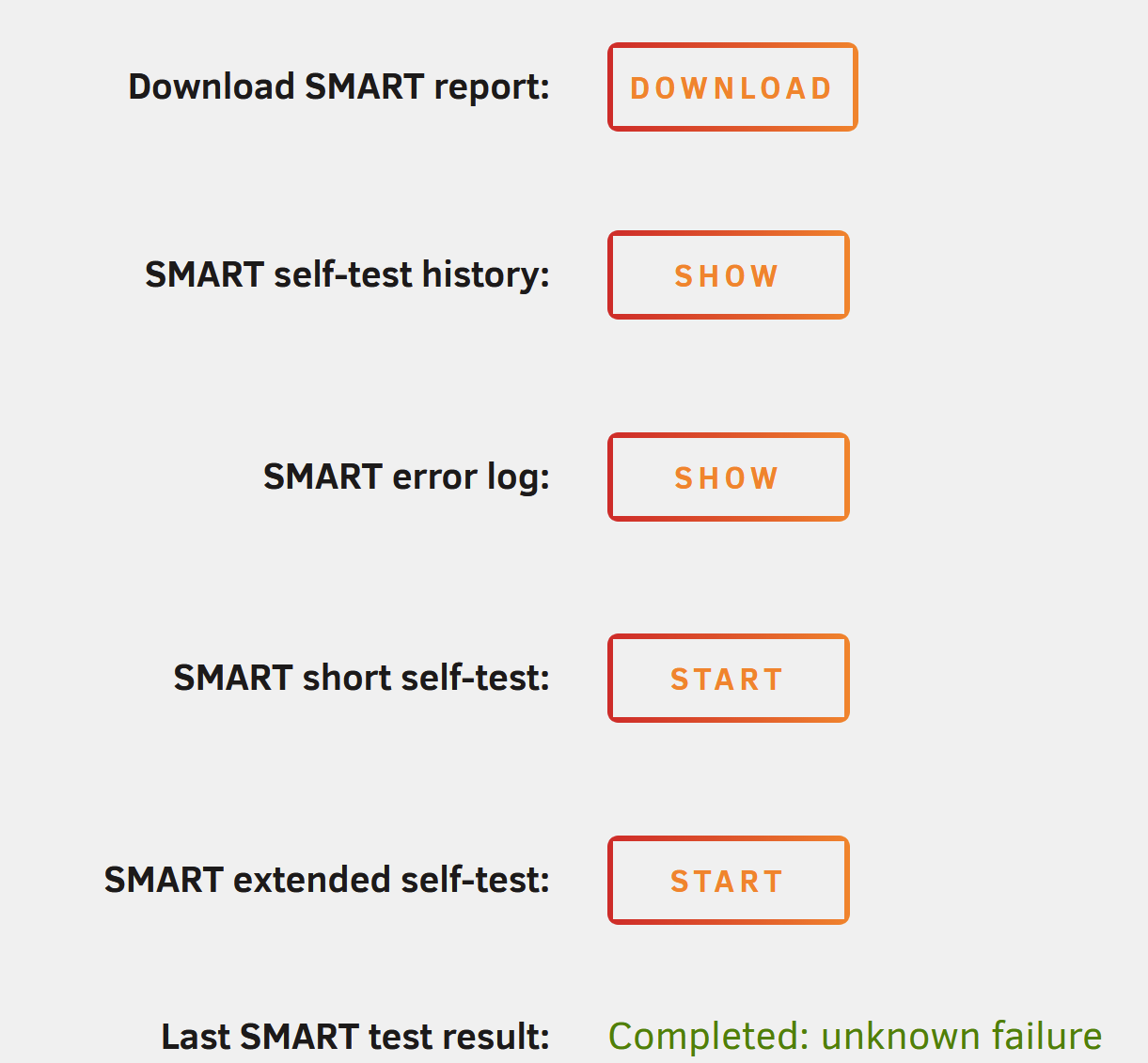

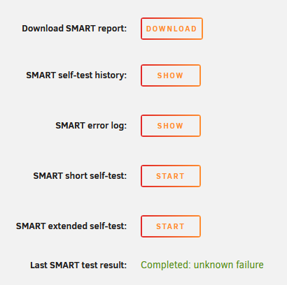

  1. I'm in the process of tryting to RMA my parity drive, and the company who supplied have asked for: Photo of the SMART test result (You may run a Seatools test on the drive or use the free trial of HD Sentinel to check its health.) Is it possible to run either of these things in Unraid? When i try and run either the of the self tests within unraid, i get an unknown error (Diagnostics attached). I am unaware it's not a recommended controller, i do intend to change as part of a hardware upgrade shortly. sap1ent_diagnostics-20260311-2321.zip Sap1ent-smart-20260311-2319.zip

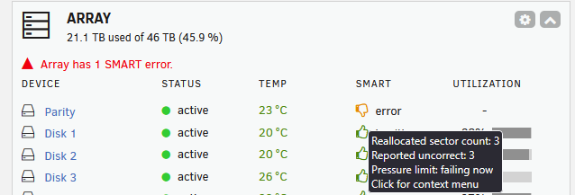

  3. Hi there, Could anyone help with the following error from my parity drive? It's a factory refurbished drive that's barely been used. 20TB. I've included the diagnostics zip. Also, whenever I try and run the SMART test it fails. Thanks in advance! (If you could refrain from telling me I need to buy a new one, it would be appreciated .😉 ) sap1ent-diagnostics-20260304-0952.zip

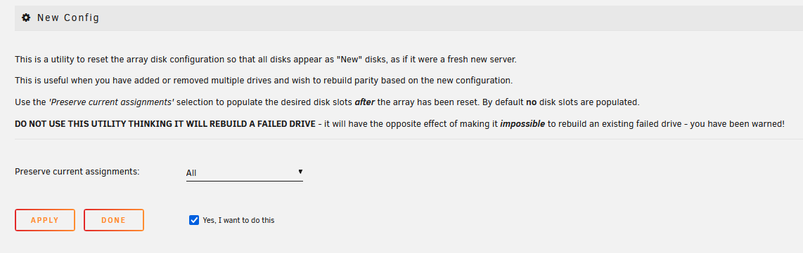

  8. Thanks again @JorgeB Just about to do so, but just wanted to double check Preserve current assignments and 'retain current configuration' mean the same thing? Appreciate they are very close and wording may have changed in a later build, but i'm extremely risk averse at this stage!

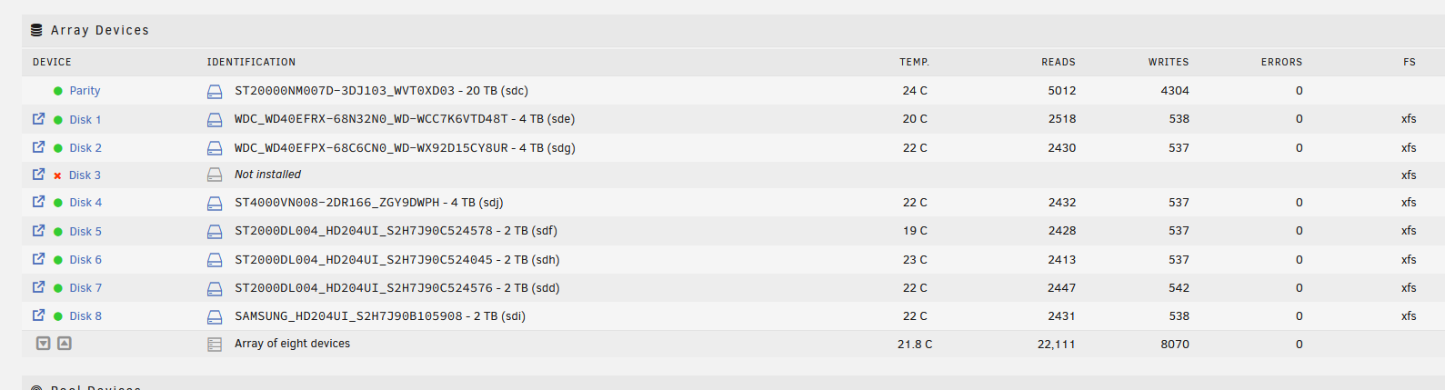

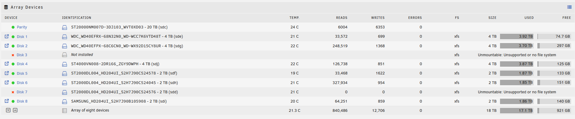

  14. Hello, Seeking some help, trying not to panic. I recently decided to upgrade a lot of my disks, I had 8 (smallish) data disks and a parity. I upgraded the parity to a 20TB drive and rebuilt, all went well. I then proceeded to try and swap a data disk, and since unassigning the disk (3), i've lost another disk (7), I think the disk itself has mechnically stopped working. Which leaves me in this situation, 2 failed disks, but the array is up & running (image), files accessible etc, however, if I stop it, I can't seem to replace the broken disks. I've also attached the diagnostics file. Thanks (hugely) in advance, for any guidance whatsoever. n.b. i still have the 2tb disk i unassigned but have the 14tb disk plugged into the system. sap1ent-diagnostics-20260225-1854.zip
