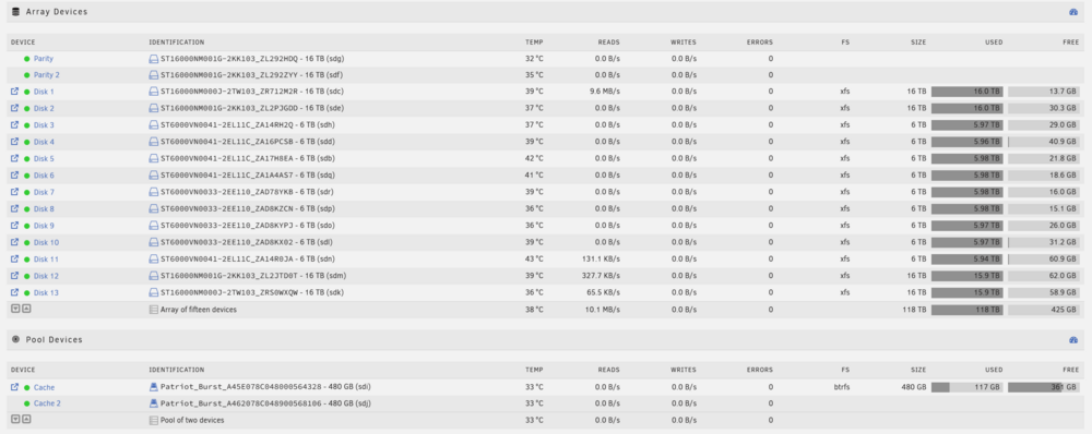

What speed are you getting?
Are you not seeing ERRORS in the ERRORS column in MAIN - Array Devices for parity2 and disk2?
nothing is showing on the gui as far as errors
Also speeds are going back down to down to 1MBs during parity checks. it goes in bursts and is not constant.
although for whatever reason as I opened obs to record it for you it's now maintaining 1gbs for at least 4 mins...
Possibly not the only issue, but first check/replace cables for those disks to try and get rid of the ATA errors, then post new diags during a check.
