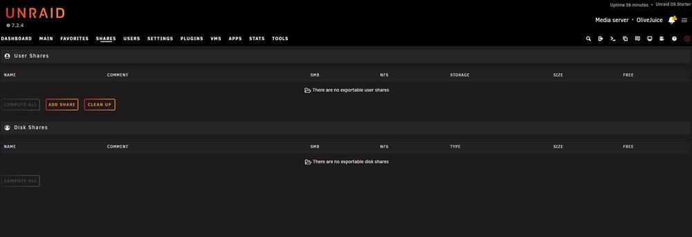

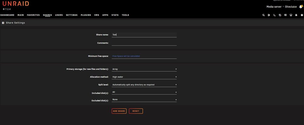

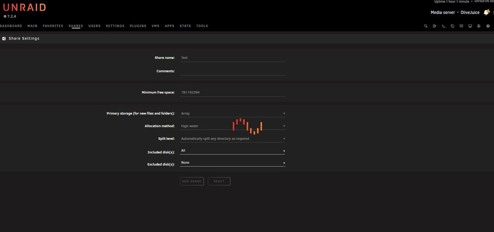

No, nothing is showing up and I am not able to create new shares. When I try to create new shares "test" and click ADD SHARE, Unraid processes the request but nothing shows up.
But then nothing shows up in the shares folder.
Your user shares are still broken due to the corruption on NTFS cache. Copy what you can and reformat.

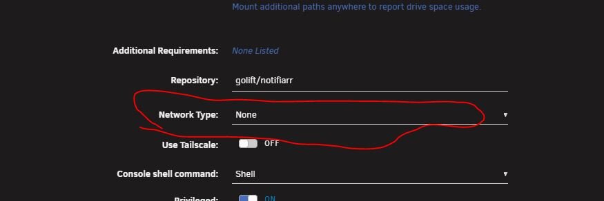

My custom network is missing and not selectable from the Network Type within the config of the container.

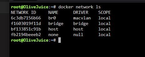

I also opened the terminal and typed "docker network ls" and it is missing.
I am assuming that I just recreate this and set all of the containers to my custom network? Why would I have lost my custom network? thoughts?

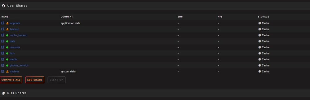

All of my shares are now set to the cache as the storage location. Obviously this is incorrect. I am under the assumption that appdata and system should be set to cache but what about all of the others. Previously I had set most of my shares to array and a couple of them to cache-array but I was wondering if there is a preferred structure for this?
