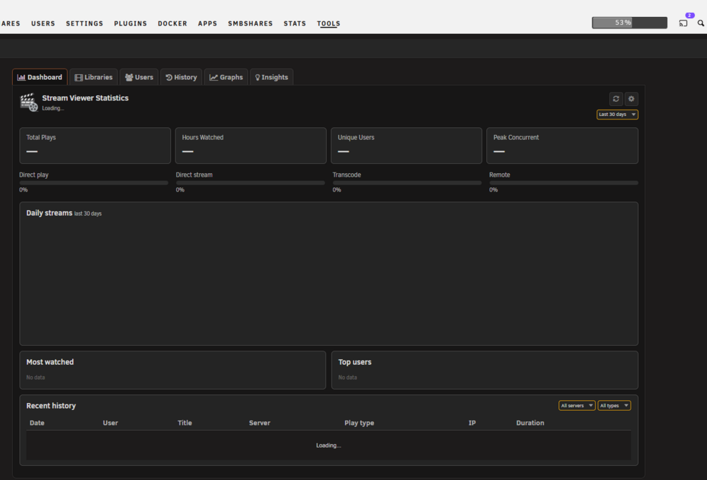

Stream viewer stats seem to not be working for me i have it enabled but it never generates any data in any tab and just says loading at the top. I see in the settings it says "Records to SQLite" do i need to install my own and point the database path to it or is it prebuilt into the plugin
Hey @derriang, no you don't need to install anything separately, SQLite is built into the plugin.
From the screenshot it looks like the page is stuck on loading.
Try hitting the refresh icon in the top right corner of the statistics page first, that should kick it into loading the data.

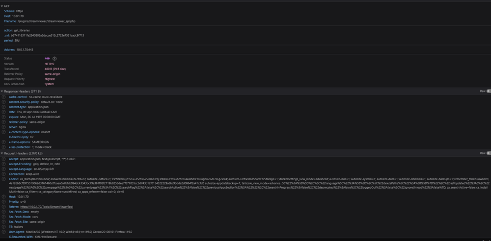

nothing seems to be generating int the Stream-Viewer folder its still empty this is one of the red errors
Content-Security-Policy: Ignoring ‘block-all-mixed-content’ because mixed content display upgrading makes block-all-mixed-content obsolete
. StreamViewerTool
[UnifiedMount] Mounted 5 components auto-mount-Wq-TItQE.js:51979:11
XHRGET
https://10.0.1.70/plugins/streamviewer/streamviewer_api.php?action=get_stats&_svt=b874116311fa2840805a3dacce312c2723e7551cadc9f713&period=30d
[HTTP/2 400 39ms]
GET
Status
400
VersionHTTP/2
Transferred400 B (29 B size)
Referrer Policysame-origin
DNS ResolutionSystem
XHRGET
https://10.0.1.70/plugins/streamviewer/streamviewer_api.php?action=get_daily_chart&_svt=b874116311fa2840805a3dacce312c2723e7551cadc9f713&period=30d
[HTTP/2 400 37ms]
XHRGET
https://10.0.1.70/plugins/streamviewer/streamviewer_api.php?action=get_top_media&_svt=b874116311fa2840805a3dacce312c2723e7551cadc9f713&period=30d&limit=5
[HTTP/2 400 40ms]
XHRGET
https://10.0.1.70/plugins/streamviewer/streamviewer_api.php?action=get_top_users&_svt=b874116311fa2840805a3dacce312c2723e7551cadc9f713&period=30d&limit=5
[HTTP/2 400 38ms]
XHRGET
https://10.0.1.70/plugins/streamviewer/streamviewer_api.php?action=get_history&_svt=b874116311fa2840805a3dacce312c2723e7551cadc9f713&period=30d&page=1&per_page=10
[HTTP/2 400 48ms]
