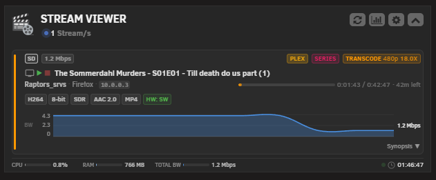

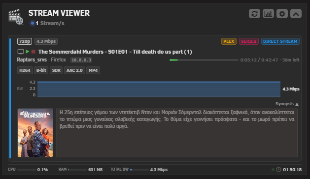

New Active Stream/s tab in statistic page
Bandwidth chart per stream card.
New "Network bandwidth capacity" setting in Widget settings controls the ceiling of the Total BW bar in the footer

Thanks for this great tool. I have a question about the dashboard view. In the “Most Watched” view, it seems that if you pause a movie or TV show while watching it and then resume it, it shows up as having been watched three times instead of once. But in reality, only one person actually watched that episode. Is there any way to work around this? I hope you understand what I mean?
