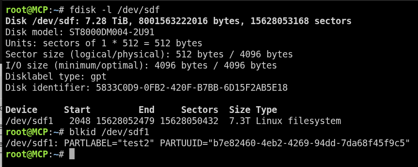

Partition layout appears to be wrong, with the array stopped post the output from
fdisk -l /dev/sdf
blkid /dev/sdf1
This can be done from 7.0 or 7.2
fdisk -l /dev/sdf
blkid /dev/sdf1
attached
Unraid 7.0 is not using the actual partition layout because it's not the standard Unraid layout, it just ignores it, but from 7.1 Unraid will use the actual partition, hence the issue.
You should be able to resolve this by deleting that partition and creating a new one with the correct layout. This should not cause any issues with the current data, and to avoid a new config, should be done in 7.0 with the array stopped.

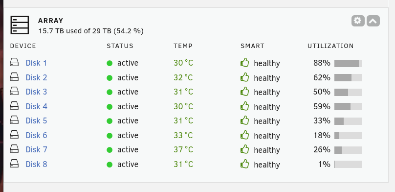

I was able to complete the upgrade to the latest version 7.2.4. Thank you for your assistance!
