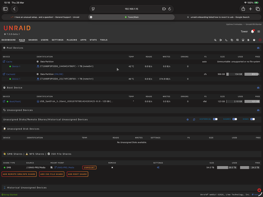

But now I have this and can’t get into the Onboarding Wizard, it just doesn’t open.
I have it back up and running but it will only boot from USB. I get this notification :

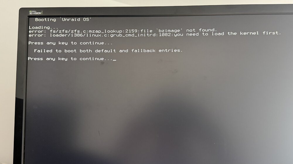

And I now have only 1 SSD in the cache obviously. No idea how to fix now so that I can use internal boot because the Onboarding Wizard no longer works.
Changing boot order in BIOS results in the missing bzimage error etc..

Then unassign that pool device and set the pool to 0 slots, then rerun the wizard to create the boot pool, but the same thing may happen again. It looks like the boot pool was correctly created; it's just not booting. It could be a BIOS/firmware issue.
There is no option to set the pool to 0 slots.. only 1 upwards..
Also it won’t let me start the array with the drive unassigned. Remove pool is also greyed out.

It's detecting a boot pool, you can do a new config, then assign only the other pool device.
Tools - New config - Keep none - Apply
Then add a pool with nvme1n1, leave the fs set to auto, and start the array
Now stop and run the wizard (other device must have been cleared)
Ok, have a new config and the original boot drive is in unassigned devices. However Onboarding Wizard still won’t run.
I tried running the blkdiscard command again on it, but the wizard still does nothing. Doesn’t even bring up the UI for it.
I suspect that the wizard thinks it is already set up. No idea what to change so that it will run again.
