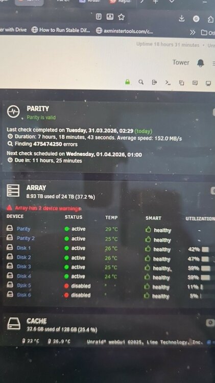

I have an array made from 2 parity disks and 6 data disks. (2 old WD reds and 6 Seagate Ironwolfs, all of them 4TB).
For the last 6 months one of the parity drives was unhealthy (CRC errors) but as the array wasn't getting much use, i figured i could leave it as is. Yesterday evening it was marked with a red X in MAIN, so I decided to replace the drive with a new one (i bought it when the parity drive showed as unhealthy). As i didn't know which drive was which, i had to turn off the array, remove a sata cable from one drive, reboot and see which drive disappeared from the list. I got the faulty drive on my second attempt and replaced it with the new drive.
After boot I selected the new drive in "Parity 1" position and started the array. It went into "parity check" which i took to be rebuilding the missing data.
Today i decided to see what happened overnight and here lies the problem. It says parity is valid, that it took 7 hours 18mins to finish and it found 475.474.250 errors !?!?!. It also disabled 2 of my data disks (disks 5 and 6 are the oldest in the array, the WDs and they were working fine and healthy when rebuild started). I have attached a photo of the MAIN webpage. I also see that "log filesystem" is maxed out.
If i click on one of the disabled disks, i can't see attributes/ capabilities or run SMART tests.
What do i do now? i have data on those disks and, shamefully, no backup. Is there a risk of data loss or can this be recovered?

Probably nothing wrong with the original parity disk. UDMA CRC ERRORS are connection problems not disk problems.
And you may have disturbed connections to other disks.
Attach Diagnostics ZIP to your NEXT post in this thread.
And no way rebuild could finish that quickly. I doubt new parity can be trusted at this point. Hopefully nothing really wrong with any disk and we can just New Config.

Are you sure it said it was checking parity instead of rebuilding?
I see write errors for disk6 where it tried to writeback to the disconnected disk, but don't see any write errors for disk5 that would have disabled it. Maybe it didn't try to writeback to disk5 since only 1 parity was valid. Or maybe the disk5 writeback wasn't logged since log space filled up.
