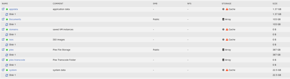

Performed an OS upgrade to 7.2.3, and array comes online without an issue, but now shares show they're pointing to storage that doesn't exist.
If I stop the array, and attempt to add cache pool, I get this:

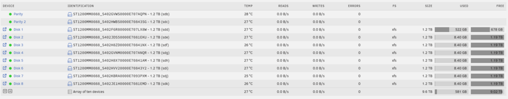

Do you have an SSD in your server? That is what would usually be assigned as cache, but we don't see any SSD in your diagnostics.
No, I use a USB flash drive as the boot, then the SAS drives. No SSD.

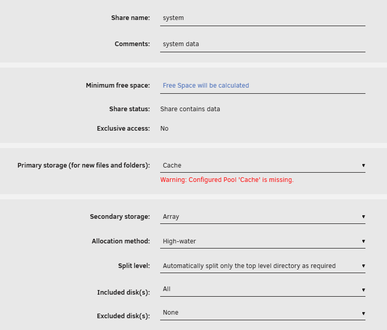

**Okay, digging into it a bit more, looks like it shares used "Cache" as a primary but the array as a secondary.

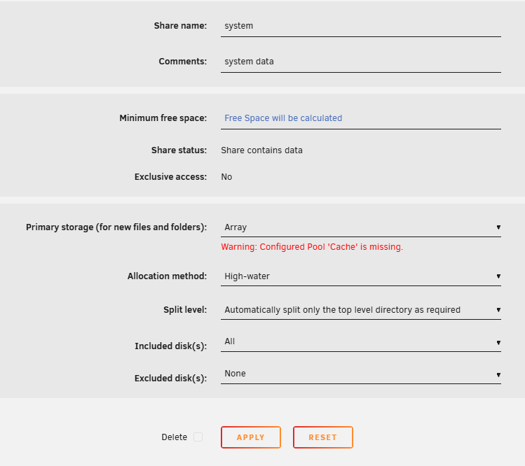

Since the primary ("Cache") is missing, couldn't I just remove it as the primary and make the array as the primary and just move on?
Example:
To this:

Was one of your SAS drives assigned as cache?
Your diagnostics show 10 SAS drives, 2 as parity and 8 array data disks.
How many SAS drives do you have installed?
Just now, trurl said:
Was one of your SAS drives assigned as cache? I don't believe so
How many SAS drives do you have installed? 10

Just click the shares and change them to array. It's probably an old setting, but newer releases warn about it.
