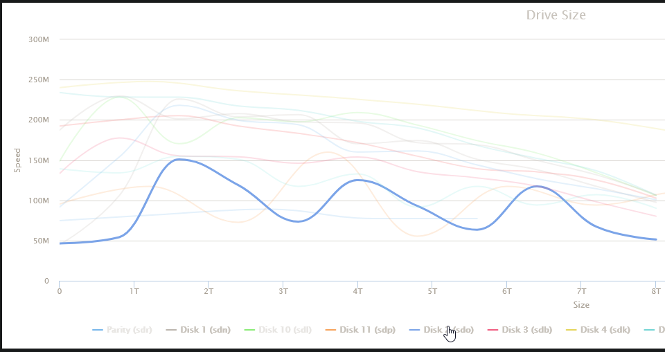

I was getting a number of Speed Gap warnings, so I decided to run it with that disabled. I think I found my problem:

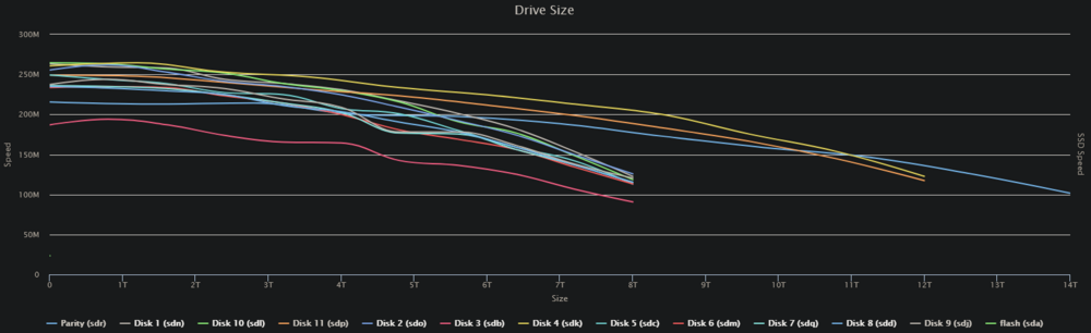

The question now: Why has Disk 2 suddenly decided to read so slowly??? My last parity check last month:
Hard to believe that the overall speed would have climbed to 189MB/s after a start like this from disk2.

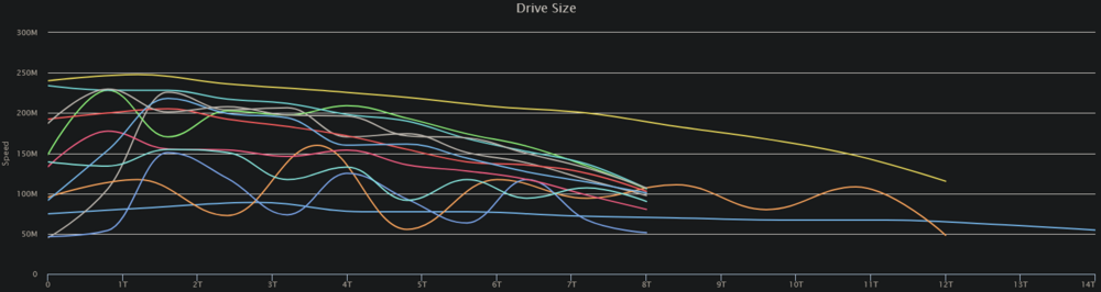

It finished just as I posted that. Overall, it's a pretty bleak picture without the Speed Gap detection.
Again, though, on March 8th was one of my fastest parity checks ever, including this 14TB drive as the parity drive.
Disk 11 (the wavy orange line extending to 12TB) is the only drive added since that last check, but it shouldn't be impacting the 1st TB speed this severely.
It's been a while since I've run that test, but there may be one or more disks with slower sector zones causing the problem.
