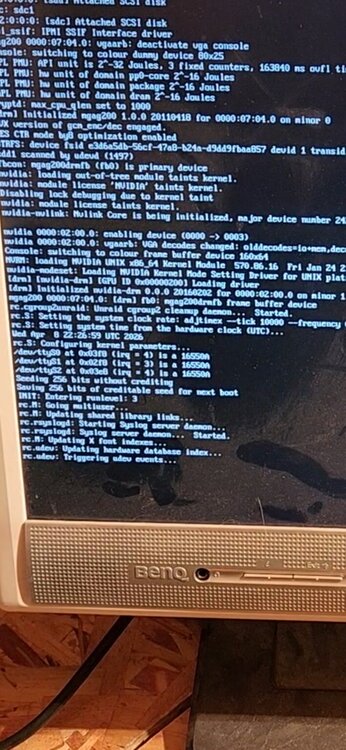

10. Boot issue encountered
System hung at:
Triggering udev events...

I can't boot to get a diagnostics.zip. Is there another way to get this?
Do you have a flash backup from before you started these changes?
Yes, via Unraid Connect.
That backup is your configuration, including the drive assignments when the backup was taken.
To see if the issue is related to the pools, you can just rename the /config/pools folder to /config/pools_bak and retest. If it boots, you can then reimport any pools.
Something the AI models tell me is that there's parameters that can be added to the boot that will display what device it's getting stuck on. Each model gives me a different parameter and none of them work. Is there any truth to this?
Not that I know of, but what I mentioned will confirm if the problem is a pool cfg file.
I got it working. It was the USB Flash drive.
