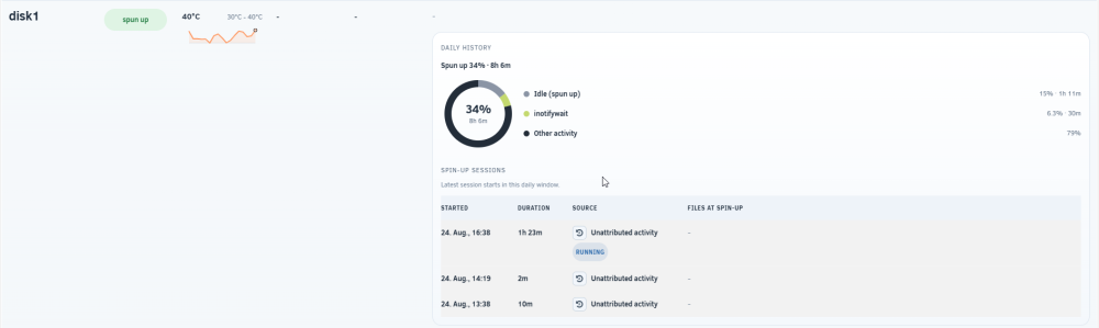

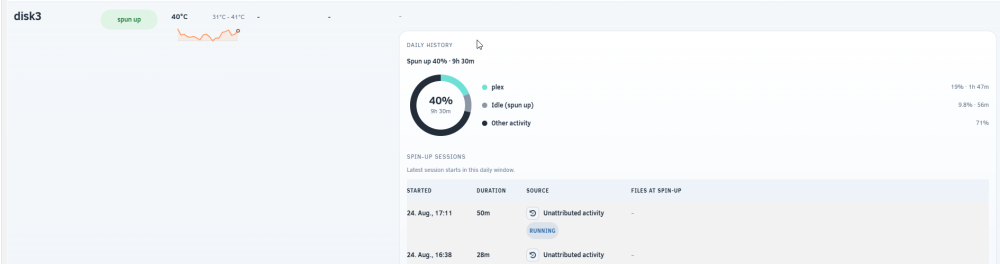

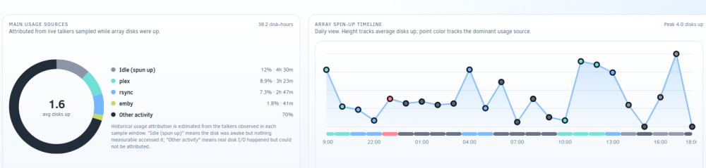

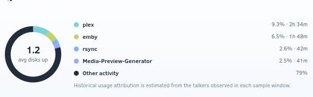

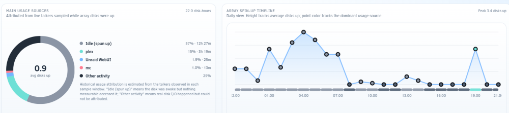

waited a few updates, but still have so much "other acticity". Any chance to identify ?
Cannot imagine what was working on HDD today between 6 an now..
Mike
@mmm77 good question, and thanks for the screenshots — they confirm exactly what I found when I dug into this. The honest answer: most of that 79% "Other activity" is time where nothing was working on your disks at all.
Disk Talkers was counting every sample window where a disk was awake but had no identifiable activity as "Other activity". So when a disk spins up and then just stays awake until the spin-down delay kicks in, all those idle hours got labeled "Other activity" — which makes it look like some mystery app is hammering the disk. That was misleading, and it should be fixed in 2026.08.24b. Two changes:
First: windows where the disk was awake but did (almost) no real I/O are now labeled "Idle (spun up)". The interesting question then becomes what woke the disk up — that is what the spin-up sessions table under each disk is for.
Second: when there IS real disk I/O but no identified app, the plugin now makes a last attempt to name the process/container holding the disk before falling back to "Other activity". So the remaining "Other activity" should shrink a lot.
Existing history will not be relabeled, but new samples after updating should mostly show "Idle (spun up)", real app names, and only a small "Other activity" remainder. Could you update, let it run for a day, and tell me how the split looks? If you still see big genuine "Other activity" blocks after that, a fresh state.json would help me dig further.
By the way, I also took the opportunity to tidy up the charts while I was in there: the timeline and the usage donut now render properly at any resolution — no more giant axis labels on wide monitors, and the layout stays proportioned on ultra-wide screens.

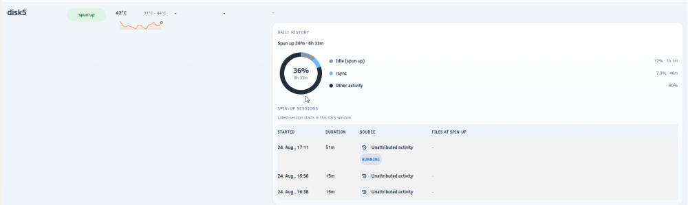

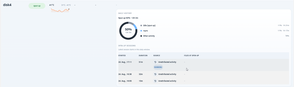

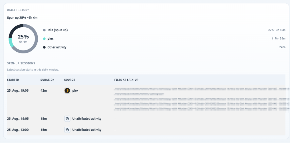

One first result after 2 hours:
There is no disk 2.
Maybe it is ZFS ? But I thought that I optimized all settings...
Will give you new information in 24h
Mike

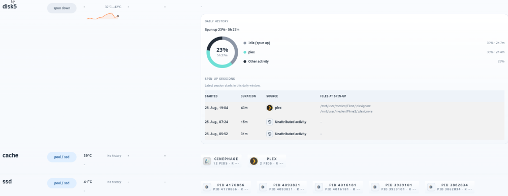

So now I can tell you some more:
But I changed something... AI gave me a code to have a look at the harddrives... (File Activity v2 did not work any more for me....)
while true; do for pid in /proc/[0-9]*; do if ls -l "$pid/fd" 2>/dev/null | grep -q "/mnt/disk[1-9]"; then echo "$(date '+%H:%M:%S') | PID: ${pid##*/} | Befehl: $(tr '\0' ' ' < "$pid/cmdline")"; fi; done; sleep 0.5; done
So it identified for me the whole night:
05:29:39 | PID: 377791 | Befehl: find /mnt/disk3/medien -noleaf -maxdepth 7
05:29:45 | PID: 377749 | Befehl: find /mnt/disk5/medien -noleaf -maxdepth 7
05:36:09 | PID: 816017 | Befehl: find /mnt/disk5/medien -noleaf -maxdepth 7
05:36:09 | PID: 816057 | Befehl: find /mnt/disk3/medien -noleaf -maxdepth 7
05:36:16 | PID: 816017 | Befehl: find /mnt/disk5/medien -noleaf -maxdepth 7
05:36:22 | PID: 816017 | Befehl: find /mnt/disk5/medien -noleaf -maxdepth 7
05:36:28 | PID: 816017 | Befehl: find /mnt/disk5/medien -noleaf -maxdepth 7
05:36:40 | PID: 849517 | Befehl: find /mnt/disk5/medien -noleaf -maxdepth 7
05:36:47 | PID: 849517 | Befehl: find /mnt/disk5/medien -noleaf -maxdepth 7
05:36:53 | PID: 849517 | Befehl: find /mnt/disk5/medien -noleaf -maxdepth 7
05:36:59 | PID: 849517 | Befehl: find /mnt/disk5/medien -noleaf -maxdepth 7
05:52:30 | PID: 1896131 | Befehl: find /mnt/disk5/medien -noleaf -maxdepth 7
05:52:30 | PID: 1896151 | Befehl: find /mnt/disk4/medien -noleaf -maxdepth 7
I found out that I still had installed Dynamix Cache Directories
So now I disabled this and it seems to be solved...... Don't know why the plugin started to do this...
13:00 was daily mover
from 19:00 it was daily plex and emby automatically maintenance and so on...
But how can I help you to identify such things...
Mike
Edited by mmm77

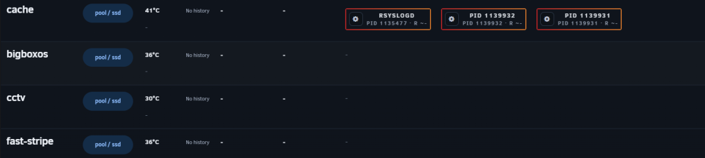

Hey @meaning ,
Awesome plugin, thanks!
Is it tested to be working with ZFS pools?
I am seeing absolutely no history for the ZFS pools, only for the array disks.
It also looks like some of the zfs hdd pools are recognized as pool/ssd.
1 hour ago, surikan said:
Hey @meaning ,
Hey @surikan ,I don’t have a ZFS pool to test on myself (my ZFS users so far confirmed live attribution works, and the history mechanism is filesystem-agnostic), so I’d really appreciate it if you could update, let it run for a day, and confirm both the history and the hdd/ssd badges look right on your ZFS pools. If a pool still shows the wrong media type, tell me its name as it appears in Main. ;)
@mmm77 first of all, sorry for the very late reply — your post deserved much better than a month and a half of silence.
Your night of detective work paid off twice. You found your own culprit (Dynamix Cache Directories), and you also exposed a real blind spot in Disk Talkers: those "find ... -noleaf" scans only open directories, and the kernel watch the plugin used did not report directory opens at all. A pure folder walk opens almost no files — so the busiest process on your disks was literally invisible to the plugin, and its time collapsed into "Other activity". That is also part of why library maintenance scans were hard to attribute.
This is fixed in 2026.10.12b: directory opens are now monitored too, and since "find ... -noleaf -maxdepth N" is the exact signature of Cache Directories, it now shows up named "Folder Caching (cache_dirs)" — on my test box a cache_dirs-style scan gets attributed within seconds. Generic find runs show as "Directory scan (find)", and the mover was already named.
So, to answer your question "how can I help you to identify such things": you already did, more than you know. Thanks for the persistence — and sorry again for the slow answer.
I have the plugin installed for a few months now and it had never shown any historical data and correct media type. " tell me its name as it appears in Main" --> Bigboxos and Cctv
Edited by surikan
