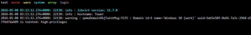

Here you go. I stopped vm/Docker. Changed share back to array only. enabled logging, ran mover, immediately stopped.
went to start back up so changed storage on system to cache and secondary to array. enabled docker and VM. Docker is showing up, VM are showing, Here is the libvery log also. (running from cache again)
Please let me know how to proceed

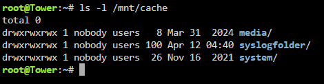

Mover has nothing to move; either the data is on a share that is not configured to be moved, or on root, post the output from
ls -l /mnt/cache
According to those diagnostics, appdata, domains, system shares are all configured to not use cache so will not be moved because there is no Mover action because there is no Secondary
