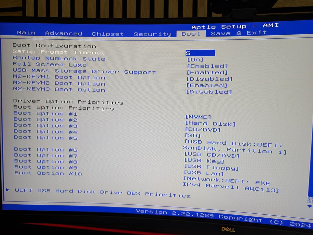

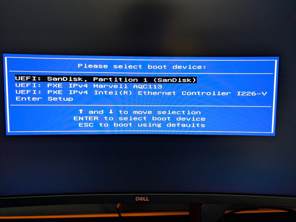

I just tried it by also removing the USB flash drive - well - it wasn't booting it just showed "Checking for media". So there is clearly nothing to boot on the SSDs. There are also set as the first boot device in the BIOS.
Does the BIOS show the UEFI boot option on the NVMe devices? Post a photo of the BIOS boot menu.
Got these two for you :)

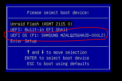

I assume the Sandisk is the flash drive?
If so, there's no UEFI boot option for the NVMe device; you may need to enable it in the BIOS, assuming the BIOS supports that, it woudl show as
UEFI: <name of the NVME device>, example:
I guess it doesn't show up as a boot device cause there is nothing to boot on it. And you can see on the second screen that the first boot option is "NVME"
That's the legacy boot option, not UEFI, which typically won't work with NVMe

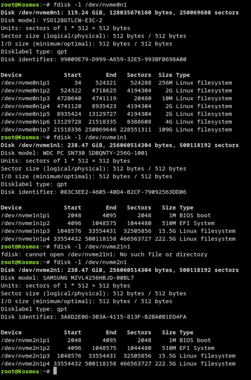

Post the output from
fdisk -l /dev/nvme0n1
fdisk -l /dev/nvme1n1
Ah I see, thanks for clarification.
I did what you said:
10 hours ago, SimonF said:
You need to enable boot for the nvmes m2-keym1 and m3 https://youtu.be/yh8Ao5ryOeE?si=3bYHcHgiK-B9w3xy
THANK YOU - that resolved the issue. Now I can see the boot partition on the SSDs in the correct way and can continue my whole setup process. :)
