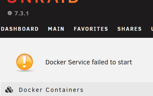

After upgrading to 7.3.0, my docker service keeps crashing.
After upgrading to version 7.3.0, the Docker service has been crashing intermittently. I have to manually restart the service each time, after which everything works normally until the issue occurs again the following day.
There are no relevant errors in the system logs. However, when I check the Docker tab, it shows that the Docker service is not started.
Please let me know what addional information Ican provide to help. I also upgraded to 7.3.1 same issue and never had this issue before on 7.2.6 or lower.

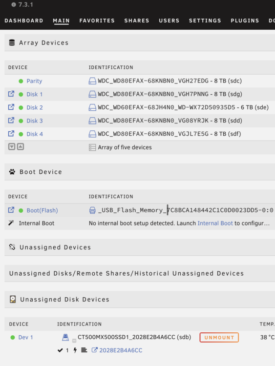

Also you have an SSD in your array, that is not recommended due to no trim support, you will likely prematurely kill the SSD. Another recommendation is to move that to a dedicated pool by itself.
This all started after upgrading to 7.3 and 7.3.1 bit hardware changes. Also my SSD is not part of the array. To prove it is not hardware, would it be recommended to downgrade back to 7.2.6 and run it for a week or so?
Yeah That's on me, I saw it in the diags but didnt note that it was unassigned. Its ultimately your call but a memtest overnight would rule out faulty ram a lot quicker than running it for a week and potentially suffering silent corruption elsewhere in other data.
