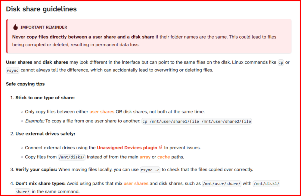

@Ksanto , I agree with @trurl. I am wondering how you created a share on the cache drive without creating a Share. I suspect you must have been working down at the Linux level. It seems to me that transfer from TrueNAS is often done by using Linux tools like rsync (or one of its derivatives) to do the move.
I have a suspicion that you might also be using Disk Shares rather than User Shares. Disk Shares are described here:
https://docs.unraid.net/unraid-os/using-unraid-to/manage-storage/shares/#disk-shares
Note these precautions if you are using Disk Shares:

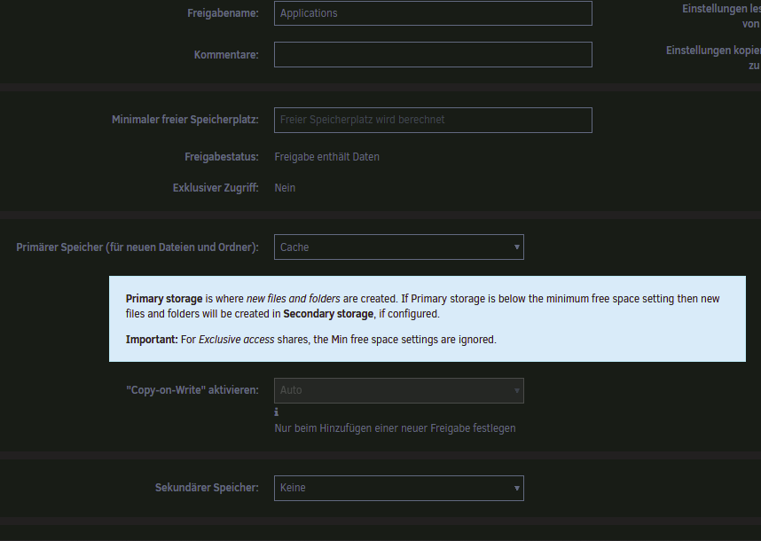

What user share, for example?
appdata and system user shares are on cache and set to only store on cache. This is a good setting for these shares.
All other shares have no files on cache, but many are set to Primary:cache; Secondary:array; Mover action:cache->array. This is the usual setting to allow files to be cached and later moved to the array.
You have one share without any settings, shown in diagnostics anonymized as
A----------s shareUseCache="no" # Share exists on disk1
This is what would happen if you create a top level folder on array or pools. It is a share with default settings, which is to not use cache, and the share doesn't have any files on cache.

That is actually the Applications folder from TrueNAS, one of the folders, but this one I will not need in the future, which is why I didn't configure it further. If I go into the settings, it shows me the following:
Yes, 'the share doesn't have any files on cache', at the moment! But as the English hint windows shown on my German system (sorry for that) suggest, all NEW files would be written to the cache instead of the origin of the folder, the array, which is the whole topic here.

I have reproduced this behavior on 7.3 by using the command line to create a top level folder on disk1. It results in a new share. The settings for that share show Primary:cache; Secondary:none. However, no .cfg file is created for that share. And, if I create a folder in that test share, it is created on cache.
This is not the way it is supposed to work.
