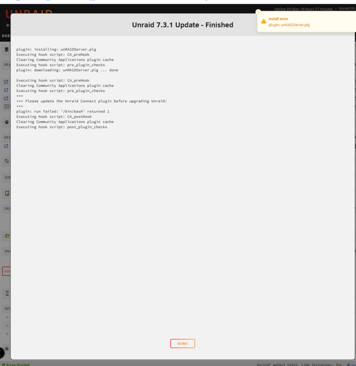

plugin: unRAIDServer.plg Plugin failed to install
i have no idea and what i can find is old info how do i fix plugin: unRAIDServer.plg

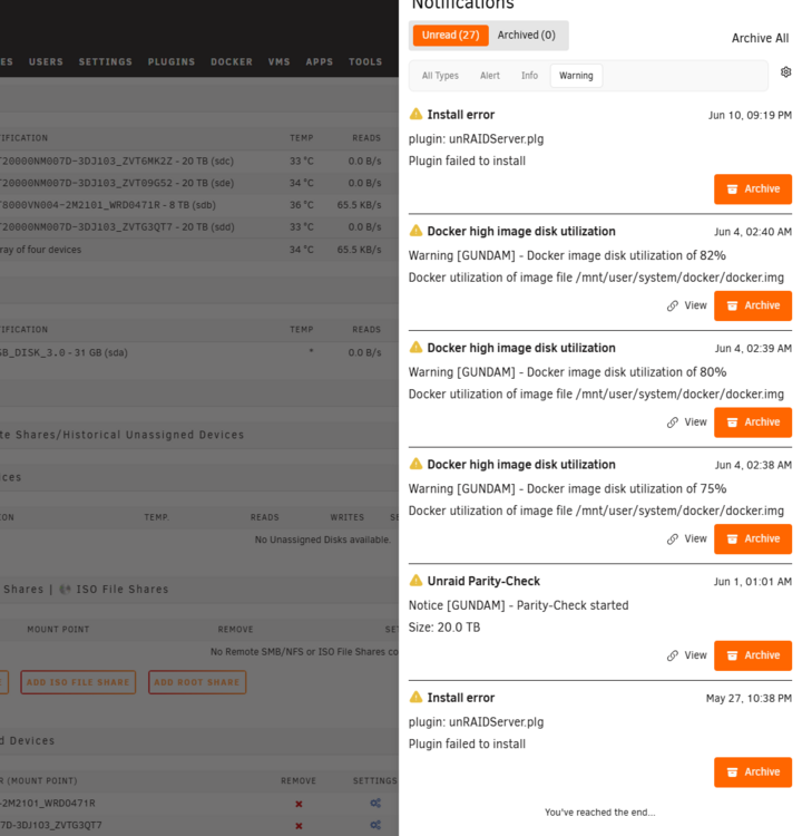

Plugin failed to install i cant even make a flash back up anymore and ive already replaced 1 boot drive and im not sure if the old back up i have is the reason for the error
I meant a screenshot of the actual update page, when it's running the update.
8 hours ago, gundam said:
unRAIDServer
What is this Plugin?
Unless I'm mistaken, that plugin is used when you try to update the server: Tools - Update OS.
Says right there, you have the Connect plugin installed but not up to date, have to update it first. Should always update all plugins before updating the OS anyway.
You can used the Update Check Tool under Tools to Check Common Issues for the Update.
