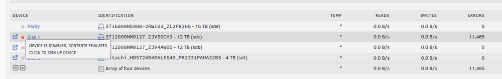

Hello All,
Hoping for some help, please - I am getting the status shown below. I have read through previous posts on this subject but not sure where to turn. I have ordered some new sata cables just in case. Logs attached.
server-diagnostics-20260611-1252.zip
Emulated disk1 is mounted, and SMART report for disk1 looks OK. Syslog indicates connection problem, and also some corruption.
Check connections, both ends, SATA and power, including splitters. Careful with connections of other disks.
Then check filesystem on disk1.
Actually syslog indicates connection problems with another disk also.

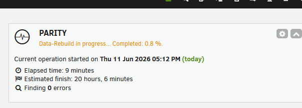

Why did you start rebuilding disk1?
You did exactly what the docs say to do if you want to rebuild to the same disk. You unassigned the disk, started the array, stopped the array, reassigned the disk, started the array to begin rebuild.
https://docs.unraid.net/unraid-os/using-unraid-to/manage-storage/array/replacing-disks-in-array/#re-enabling-a-disabled-disk-rebuilding-onto-itself
But since it is unmountable, the result of the rebuild will be unmountable.

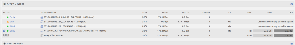

But those first diagnostics had all disks mountable but syslog showed some corruption on disk1.
Now disks 1,2 both corrupt and unmountable.

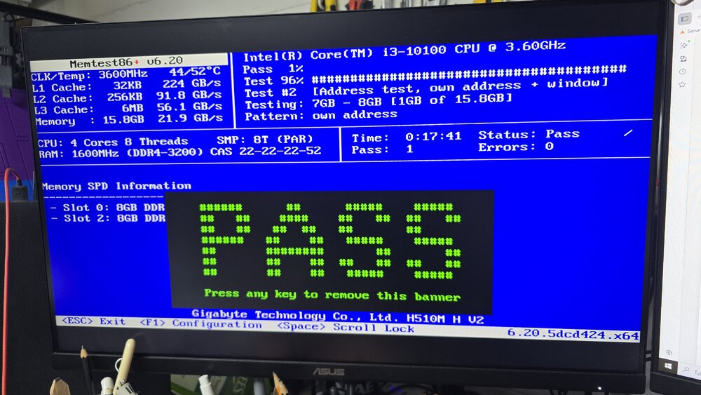

Do memtest before doing anything else.
Memtest for 1 cycle has passed
This would ideally have been done before starting the revbuild, but it's still the next step; check filesystem for both unmountable disks.
Disk2 doesn't look too bad. Click the FIX button on that one then start the array in normal (not maintenance) mode and post new diagnostics.
