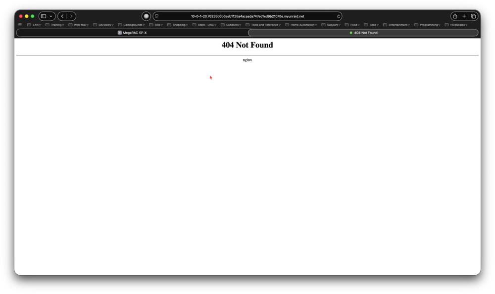

I seem to have lost ability too connect using myunraid.net address. Just get a 404 error-
After reboot I was able to connect using the local IP but still a 404 using myunraid.net. Attached diagnostics taken automatically during the shutdown process to boot/logs in case it helps. I can also supply syslog if needed.

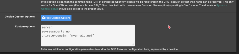

I set the code from the help menu in pfsese>services>dns resolver>custom options (so-reuseport: no was already existing)-

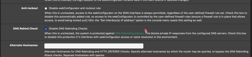

Also in System>Advanced>Admin Access>DNS Rebind Check I checked Disable DNS Rebinding Checks.
I feel like there should be some way to make this work without disabling the rebind check? Not sure if this is a real threat to my firewall now?

Actually got this fixed too. It seems that the pfsense setting recommended in the Unraid help menu in management access settings isn’t formatted properly. The help menu shows adding this setting in pfsense-
server:
private-domain: “myunraid.net”
What actually worked was this-
server: private-domain: ‘myunraid.net’
No line breaks.

A little more info from the pfsense forums. The settings page in pfsense states that settings should be separated by a line break. The unbound docs state that only a whitespace is needed but recommend using line breaks and indentation for visual clarity so the currently suggestion in the help menu should work but doesn’t.

Actually the instructions may have said separate lines. Not sure about the exact wording but my assumption was that if each setting should be on a separate line then settings that took up two lines wouldn’t work. Changing the setting so that it was all on one line fixed the failed dns query.
