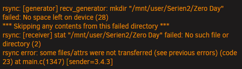

I am trying to copy a directory from "/mnt/user/Serien/U-Z" (Unraid Pool) to "/mnt/user/Serien2/U-Z" (zfsraid1). No problem with mc, but with the Dynamix File Manager I now got an interesting error message from rsync. There is enough space on the destination zfsraid1 share...
Looks like you did not adjust the min free space setting on that "Serien2" share so it still has the 10% default, i.e. 3.7TB.

That was actually correct. I have changed it now to 10GB and Dynamix File Manager can do the copy.
