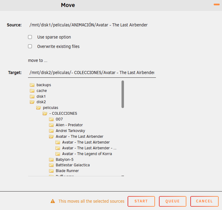

To manually balance my array's drives, I used Dynamix File Explorer's move tool to group some TV series folders, in a share that straddles two disks, into the least filled one. The UI let me choose the destination folder (a newly created one), and once launched I could see the progress in the File Explorer and the drives' activity in the main window, its speed being as expected.
But when checking the result I saw that it had hardly created some subdirectories and moved a few files. 95% of the material is just gone.

Please post the diagnostics and also a screenshot showing the copy paths used.
Thank you for your assistance. The destination folder was created before the move operation (the origin one no longer exists, so, I've recreated it). The ones in the destination hardly hold one or two files instead of the complete seasons they ought to.

I'm unable to reproduce, see if you can repro the issue (using test data) with a couple of the folders with the same or similar names as you had before.
