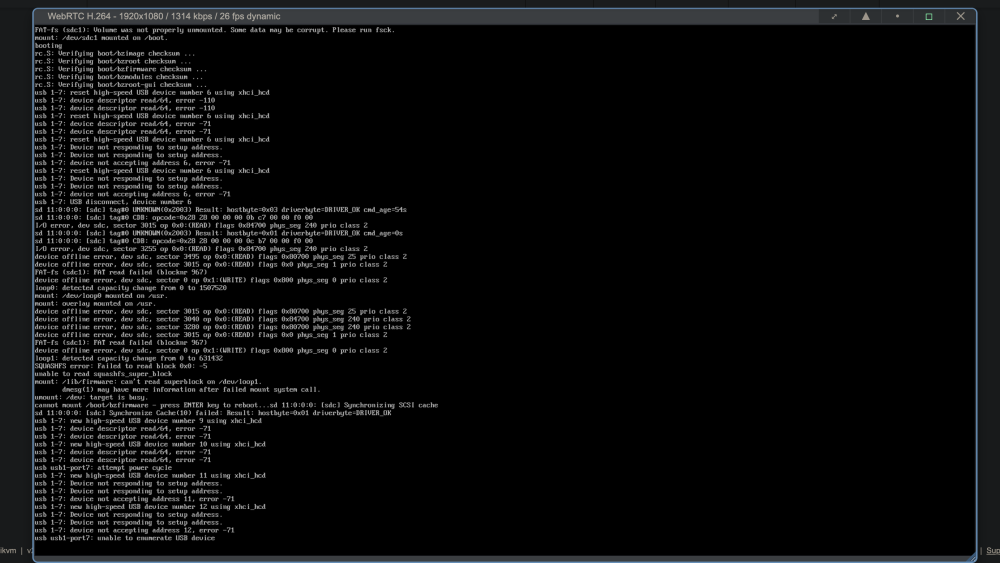

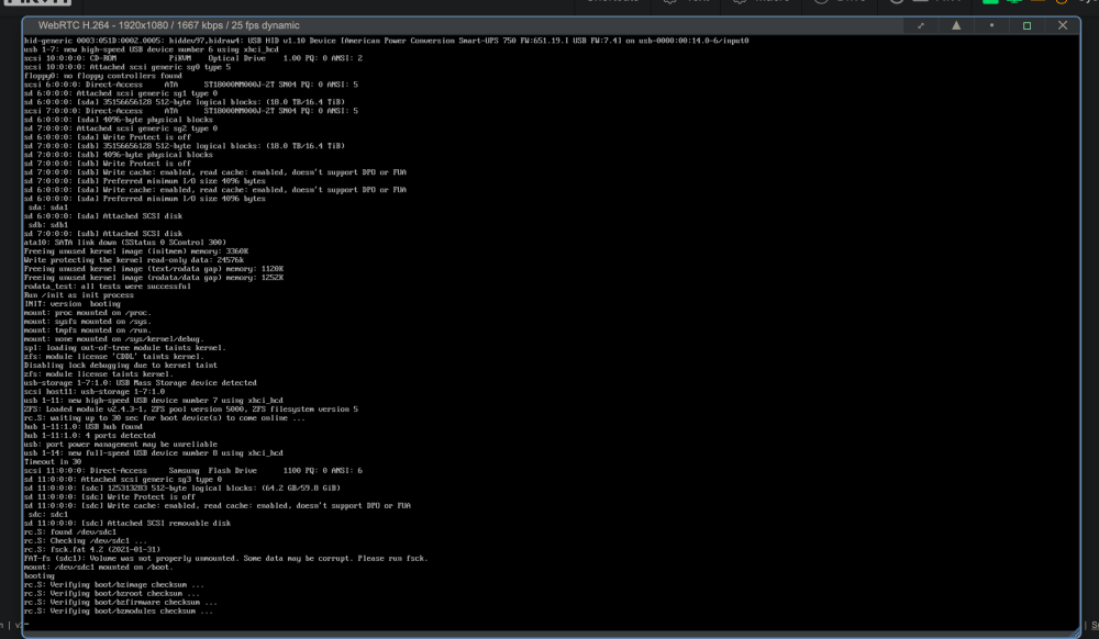

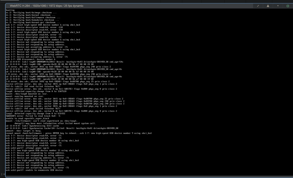

August 23Aug 23 Digging up this old thread...I basically ran into the exact same issue upgrading from 7.2.x to 7.3.2 and it's probably my USB stick giving up the ghost.tried unplugging and reinserting into the Internal USB header. It worked on the next reboot but unraid complained about a bad image and then subsequent reboots failed to detect the USB stick all together.Tried front USB port, still nada,took the USB drive and mounted on macOS and ran disk utility first aid and it did completed successfully. I did it multiple times and it strangely reported different number of files detected. Then I re-copied the 7.3.2 bz* files onto the USB drive and then tried booting with the stick in the rear USB port and it detected and booted and unraid mounted and booted successfully. I should retry the front USB port or the Internal port but at this point, I'm just happy it's booted and it's almost 3am so I'll kick the can to later me to deal with the USB drive.I think I will start looking for a USB replacement. I thought this was a reliable Samsung BAR USB drive (bought the one that everyone recommends) but it's only been 4 years. Possibly the heat from the internal USB port might have had negative consequences. Anyone got a good replacement recommendation? I know a buddy went through the trouble of getting an intel octane drive and a PCIe adapter to boot from.... worth the hassle?Thanks,
