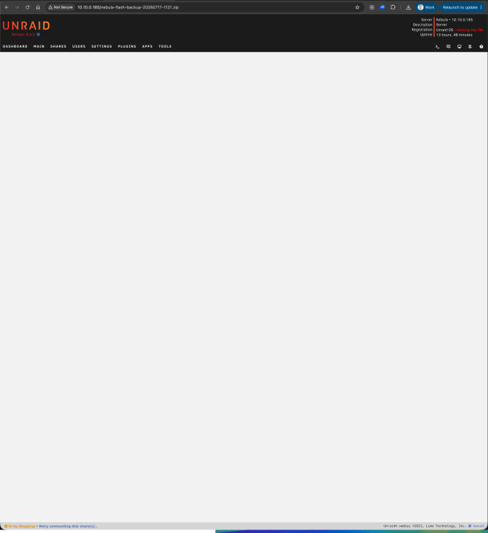

When I go to create a "Flash Backup" the screen turns white and nothing happens:
Edited by gooner_47
You need to shut down the server (by force if needed) and manually try to backup the flash drive, just need to try to copy the existing /config folder; all you need is there

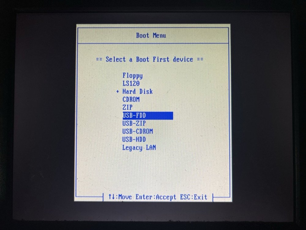

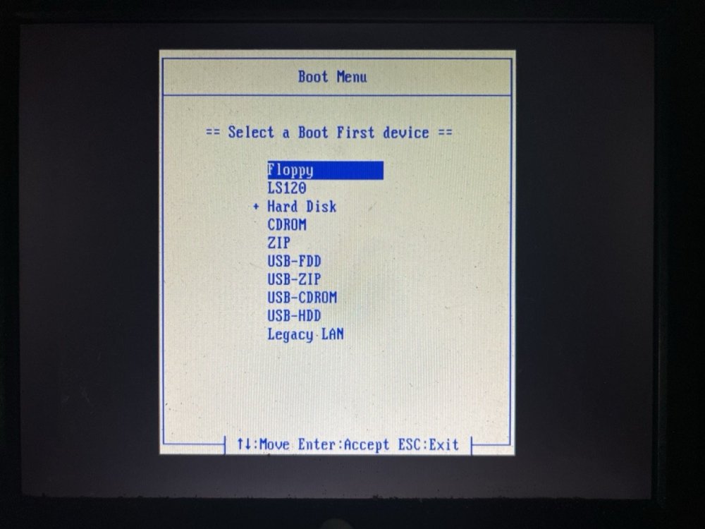

When I reinserted this in the server, and started it up, I only get as far as a PCI Devices list and it never actually boots.
Attempts to hit F12 to enter the boot menu and select the USB HDD option do not work, it simply reverts to the same screen. Also entering the BIOS setup, and changing the first boot device to USB-HDD, saving and restarting also does not help, I never get further than the PCI Devices list screen.

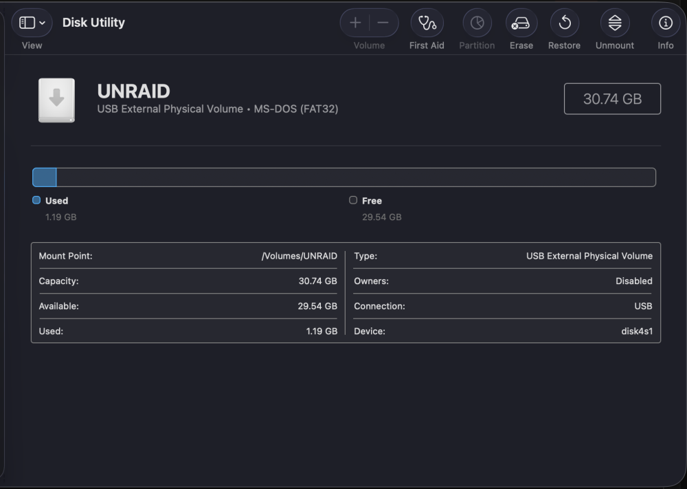

I don't see any reported issues with the usb in disk utility, it seems to just behave normally.

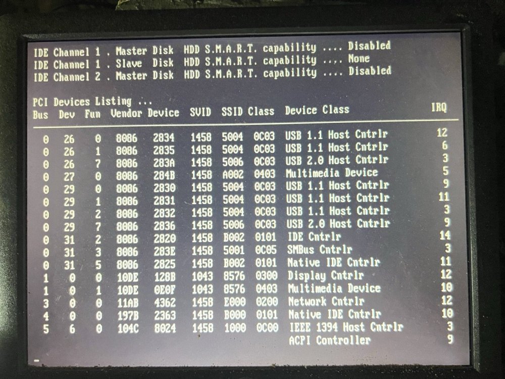

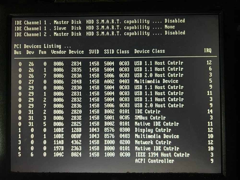

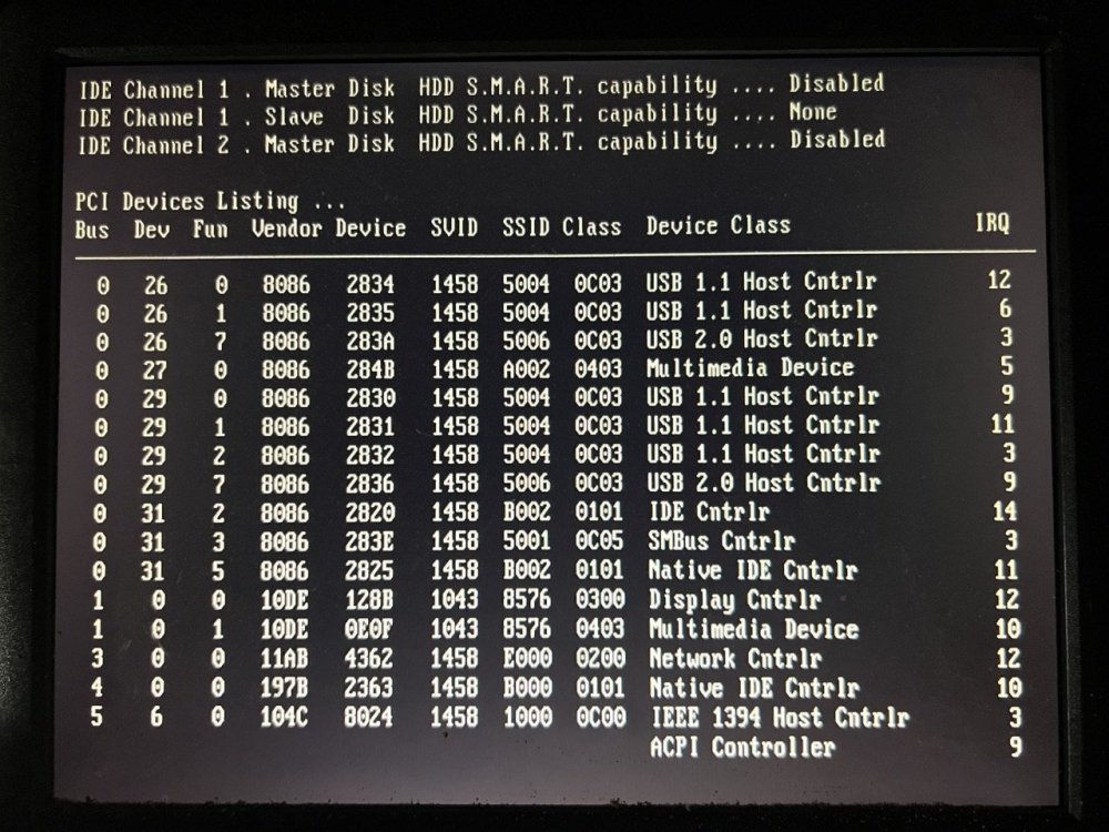

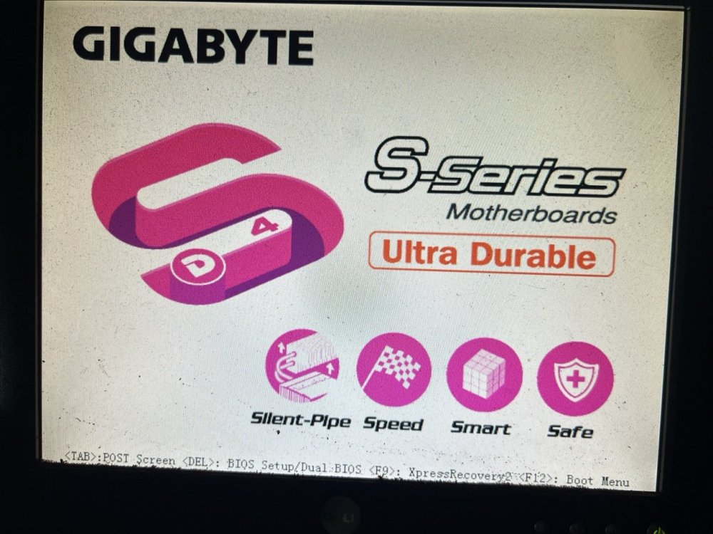

Ok so I created a new flash drive with v6.9.2. Ran make bootable mac again. Inserted it into the server and booted up, and I got stuck on the same screen.
First boot:
F10 then select USB-HDD ends up going back to the same screen:

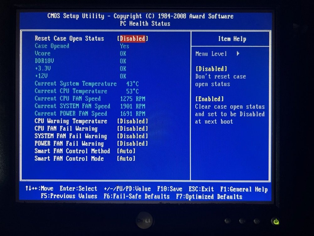

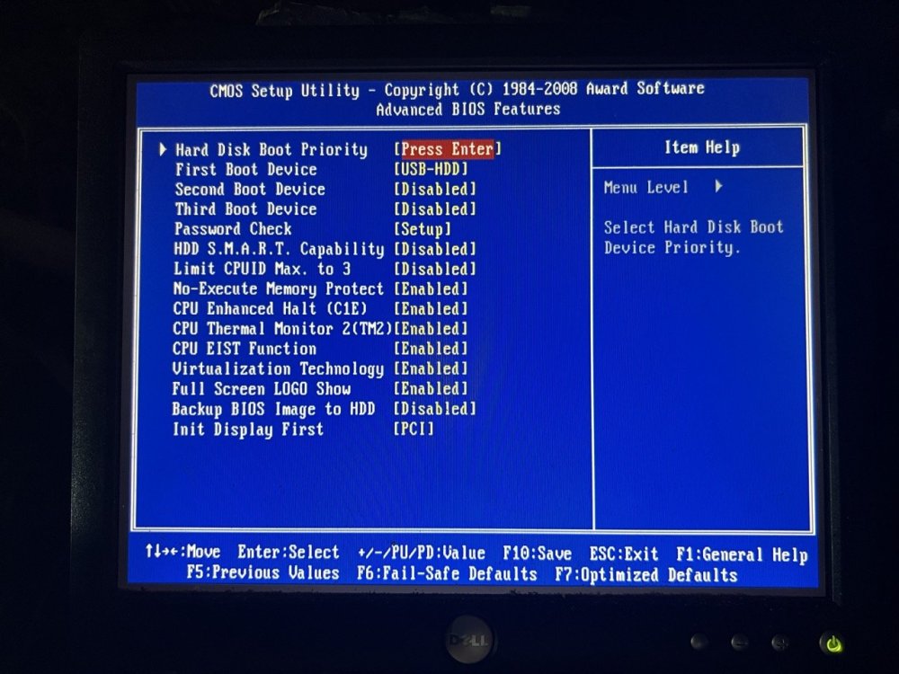

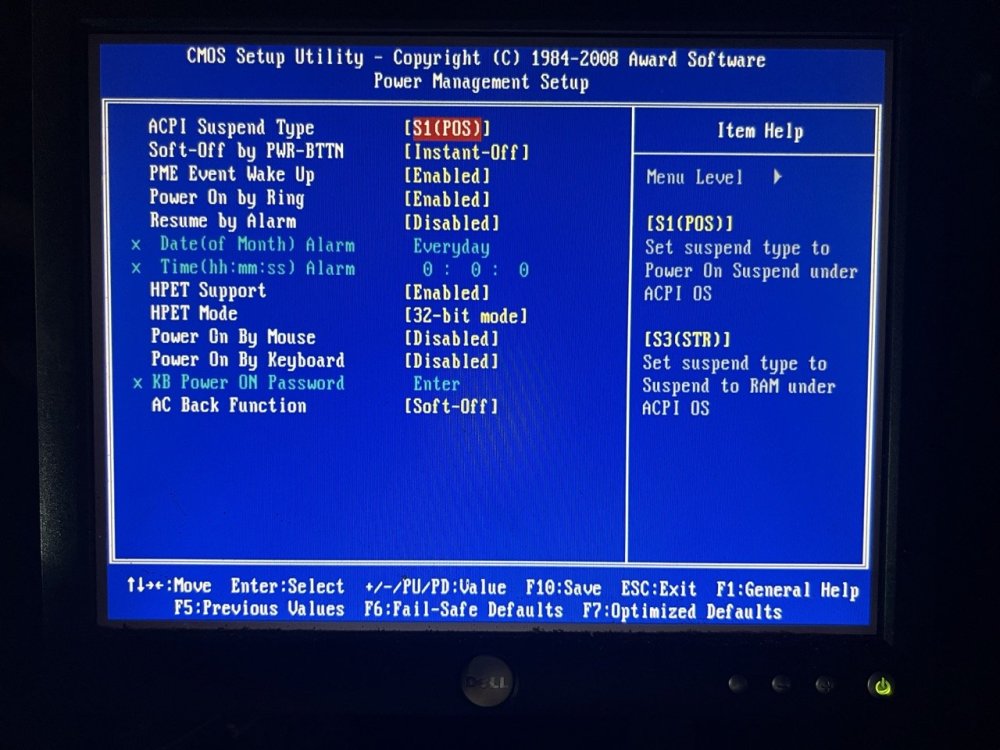

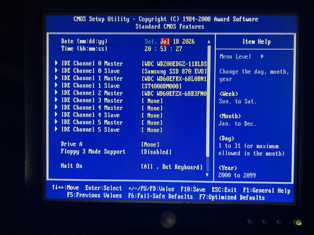

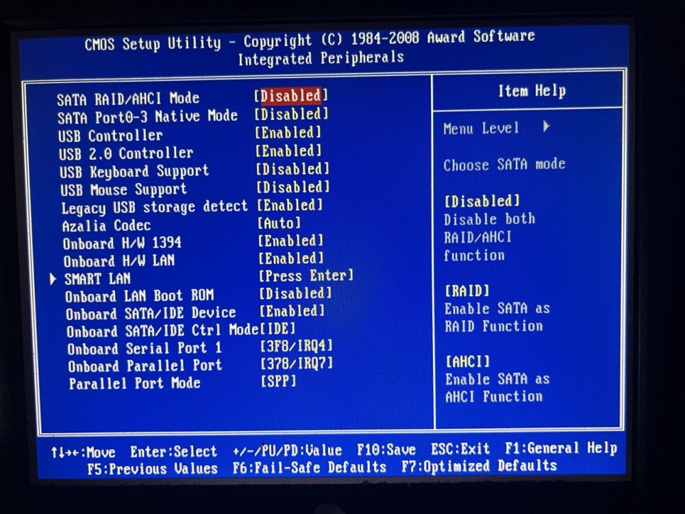

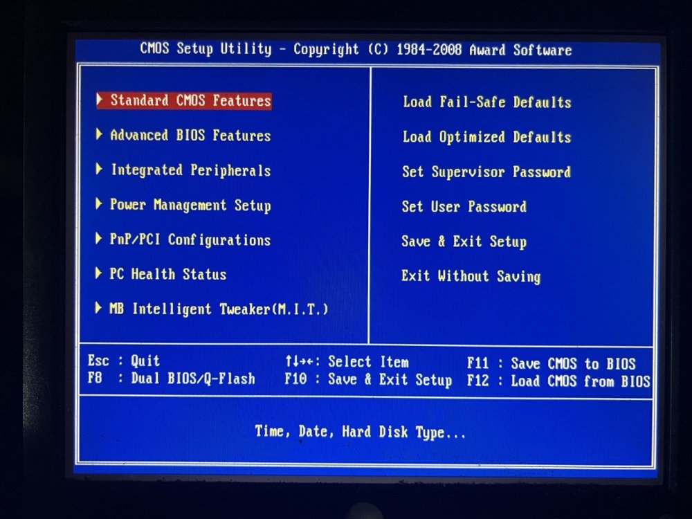

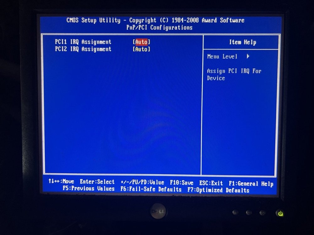

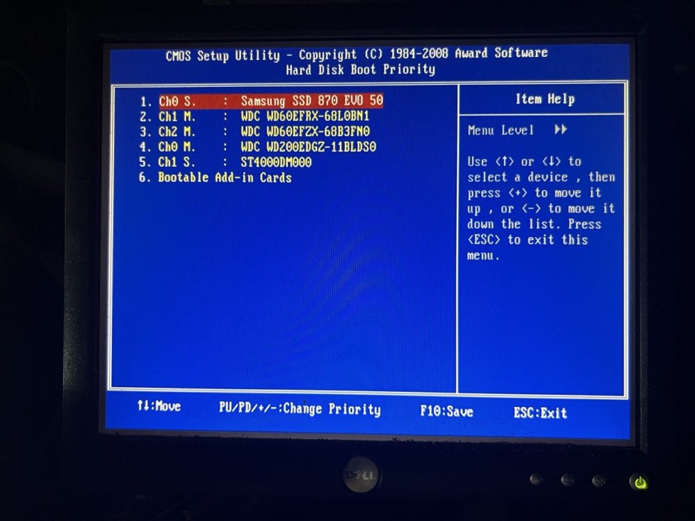

All BIOS pages in case there's anything in there:
IMG_7680 Large.jpegIMG_7681 Large.jpegIMG_7682 Large.jpegIMG_7683 Large.jpegIMG_7684 Large.jpegIMG_7685 Large.jpegIMG_7686 Large.jpegIMG_7687 Large.jpeg

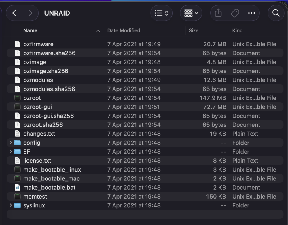

Flash drive contents:
That looks like the board is not even trying to read the flash drive; try booting it on a different PC to confirm it's working.
It looks as though the board may be borked. I used the original flash drive in another machine and was able to boot from it and get to the Unraid installation screen.
I also borrowed another, new USB drive to try in the server and no matter how much I tried I could not get it to boot from it. Tried:

Completed steps 1-5 - without the new nvme flash drive for now, as that’s yet to arrive.
I can successfully boot into unraid, but the Seagate drive is unassigned, and shows as 4GB rather than 4TB. I am also unable to see it in the BIOS.
I am also unable to see the Unraid UI on desktop for some reason, although it works fine on my phone.
That suggests a failed drive that needs to be replaced.
Same capacity as the current one presumably - 4TB?
What is the process for replacement once the new drive is here?
The replacement drive must be at least as large as the disk to be replaced. It can also be larger, but it should not be larger than your smallest parity drive (although there are ways to work around that limitation).
The replacement procedure is covered in the online documentation.
