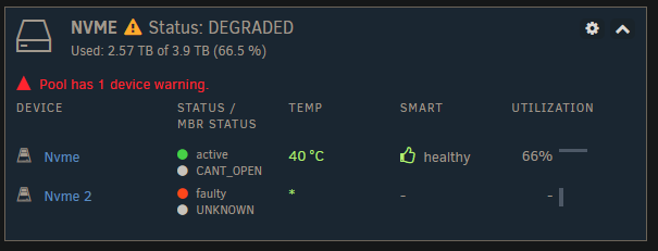

Thank you for the reply! Screenshot attached, it's the Nvme pool that I need to remove a device from. Right now the red triangle next to the existing drive says "Device has an error status: CANT_OPEN" which I've never seen before. It's also inaccurate since the drive is mounted and operating.

zfs is detecting data corruption on the remaining device, so I recommend running memtest first, then using zpool status -v to see the corrupt file(s) and delete/restore from a backup.
Thank you @JorgeB! I guess unRAID hasn't integrated zfs data integrity issues properly into the UI yet.

 Ok finally the corrupted file has been deleted, but the CANT_OPEN error is still on the existing nvme drive. A look at zpool status -v says:
errors: Permanent errors have been detected in the following files:
        nvme:<0x10f>

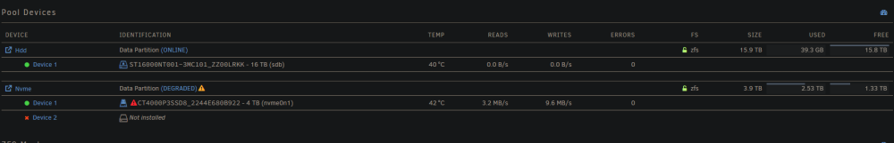

The "can't open" error is a bug, and just a display issue, the corruption is a problem, and the error typically means metadata corruption. Try scrubbing the pool, if the error remains, my recommendation would be to back up and recreate the pool.
A scrub cleared it up, zpool status -v now says

So it looks like the next step is to remove the extraneous mirror device in the Nvme pool. How would I go about doing that?

With the array running type
zpool detach nvme 13874904942354296596
Then stop the array and reimport the pool with the remaining device:
on main click on the first device for that pool and then "remove pool"
back on main, create a new pool with the same name and 1 slot
assign the pool device, leave the filesystem set to auto
start the array to import the pool
