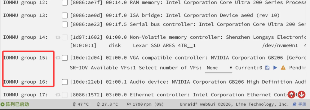

Here is a clue for reference. My friend uses Z890 + RTX 5060 Ti with GPU audio passed through to the VM. Unraid works normally after VM shutdown. It stays stable on Unraid 7.3.2 and older versions. On his system, the GPU and its audio device are in separate IOMMU groups.595D4E54BF1AC674CD92E84FB96184F8.png
