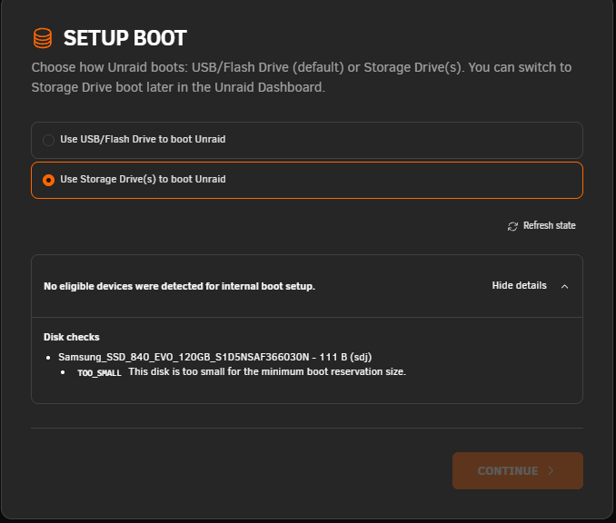

128gb Storage Drive as boot drive TOO_SMALL
I tried to make my Samsung SSD 840 EVO 120GB into a boot drive, but just get a 'TOO-SMALL' Error.
I tried formatting it numerous times, but still the same issue. Any idea into why this is, please?

The SSD is fine. Unraid sees it as a full 120 GB disk, and that's well above the minimum needed for internal boot.
The problem is the U-Manager Companion plugin. It changes how the Unraid API gets disk information, and a bug in that change reports each disk's size as a few bytes instead of its real size. For example, the wizard probably shows your SSD as "111 B". So every disk fails the size check and gets marked TOO_SMALL, no matter how you format it.

Plugin author here, sorry for the trouble. JorgeB's diagnosis is spot on: the companion replaces how the API lists disks (so it doesn't wake spun-down drives), and that code reported sizes as a few bytes instead of the real value, so every disk failed the Internal Boot size check.
This is fixed in U-Manager Companion 2026.10.04.1, released today. Updating the plugin from the Plugins page is enough: the fix applies immediately and no reboot or uninstall is needed. If you already removed it to set up internal boot, you can reinstall it and disk sizes will now be reported correctly.

Thank you both @JorgeB and @Jandrop . I re-installed the Plugin with the new update as i'd previously uninstalled it, stopped the array and the issue was immediately fixed without a reboot. Thanks!
