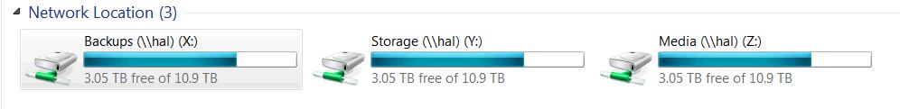

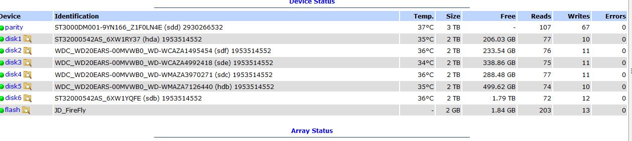

Seems like the wrong size is being shown in windows 7 for my array. Any ideas on how to remedy? Running 5.0 RC5 has been doing it since at least RC4. I think once I replaced my parity drive with a 3TB and added a 2TB it hasn't shown correctly.
Unraid reports drive size and free space calculated in base 10 while Windows reports it calculated in base 2. So when you put that new 2TB drive in your server, it reported it as having 2TB of free space. If you put that same drive, brand new, in your Windows computer it would report about 1.8TB free.
If you convert all those free space listings on your server to base 2 and add them up you get about 3TB, which is what Windows is showing as the free space of your server.

Windows is displaying the correct "formatted" size. Windows will display a 1TB drive as roughly 931GB once it is formatted, have a read of the following:
http://en.wikipedia.org/wiki/Hard_disk_drive#Units_of_storage_capacity
http://en.wikipedia.org/wiki/Terabyte
The terabyte is a multiple of the unit byte for digital information. The prefix tera means 1012 in the International System of Units (SI), and therefore 1 terabyte is 1000000000000bytes, or 1 trillion (short scale) bytes, or 1000 gigabytes. 1 terabyte in binary prefixes is 0.9095 tebibytes, or 931.32 gibibytes. The unit symbol for the terabyte is TB or TByte, but not Tb (lower case b) which refers to terabit.
Unfortunately as drive sizes get larger this gap is only going to increase, unless they change the naming convention (which is probably likely eventually) then drives will appear to start coming out in "funny" sizes. For a while they were thinking of renaming GB to BB (Gigabyte to Billion Bytes) to prevent confusion.. This would mean a 500GB drive would have had to have been sold as a 465BB..
Technically you are getting what you paid for, 12000000000000bytes
I thought 6 TB disks would be closer to 12TB total?
10.91TB usable space with 6x 2TB drives. 931GB usable per terabyte, times 12 terabytes, is 10.91TB. This is not unRAID's fault, this has been the case since the day hard drives were made. I'm kind of baffled how you claim it didn't do this before. Windows shows 43.6TB for me, which is 48TB worth of drives (51TB if you count parity).
