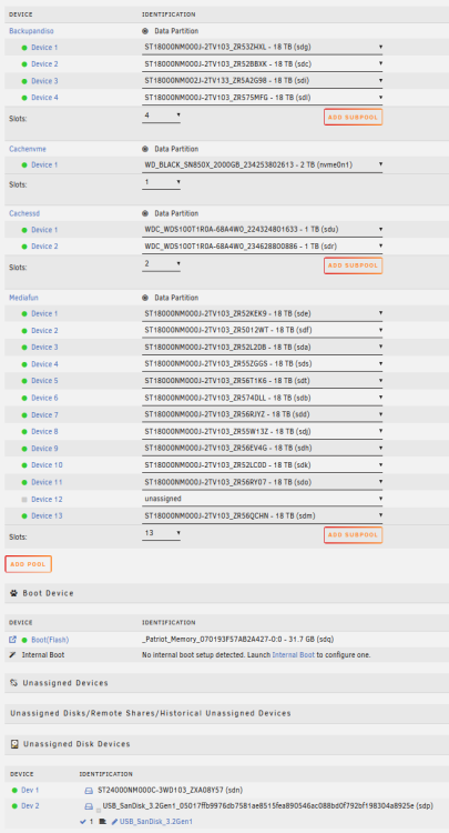

So I have a couple of zfs pools. One in particular (named Mediafun) is made up of 13 devices. I had some errors show up on one of them, Device 12 (sdn). I kept using it until the system removed the disk.
I ran a quick SMART test on that disk that came back with no errors. I tried to reintroduce it, and the resilver process started but was moving extremely slow (0.3%, 70 days to go) and didn't run for too long before the drive was shown as removed again by the system and seemed to stop the resilver process.

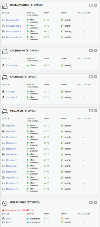

In the meantime I had a second drive, Device 5 (sdt), that started stating it had errors. I decided to shut down the server and check to see if the same breakout cable was connected to both drives as I have had loose/bad cables in the past. Device 12 (that was previously removed by the system) is connected to a breakout cable and Device 5 has a sata cable connected directly to a Sata port on the motherboard. I re-seated only those two sata cables and powered up the server.
Now all drives are showing as offline and when I try to start the array I'm receiving "Wrong Pool State mediafun - invalid config". Device 12 (sde) still shows as unassigned.
I've tried rebooting as well as assigning the drive that was removed (Device 12) back into that same slot. I'm wondering if stopping it during the resilver process was problematic as I'm seeing "sdn1/old" as OFFLINE and "sdn1" as UNAVAIL when I run zpool import.
Any suggestions would be welcome.

  scan: scrub in progress since Tue Oct 27 10:54:23 2026
        24.4T / 108T scanned at 30.2G/s, 20.1T / 108T issued at 8.68M/s
        8K repaired, 18.62% done, no estimated completion time
config:
        NAME                     STATE     READ WRITE CKSUM
        mediafun                 DEGRADED     0     0     0
          raidz2-0               DEGRADED     0     0     0
            sda1                 ONLINE       0     0     4
            sdd1                 ONLINE       0     0     4
            sde1                 ONLINE       0     0     4
            sdr1                 ONLINE       0     0     4
            sdn1                 ONLINE       0     0     4
            sdl1                 ONLINE       0     0     4
            sdh1                 ONLINE       0     0     4
            sdj1                 ONLINE       0     0     4
            sdk1                 ONLINE       0     0     4
            sdg1                 ONLINE       0     0     4
            sdb1                 ONLINE       0     0     4
            sdn1                 OFFLINE      0     0     0
            7355020672882961856  FAULTED      0     0     0  was /dev/sdm1
errors: Permanent errors have been detected in the following files:
mediaunraid-diagnostics-20261028-1856.zip

The new diagnostics look good. There are no disk or controller errors in the log for the whole boot, and the CRC count on Device 12 has not gone up since you replaced the cables. The pool status showed 8147 data errors before the erase, so recreating the pool was the right decision.
You don't need to unassign the devices first. "Remove pool" is enough:
- With the array stopped, click the first device of the mediafun pool and click "Remove pool".
- On Main, add a new pool with the same name and 13 slots.
- Assign all 13 disks. This includes the 24TB disk and the disk that was Device 13. The order is not important.
- Click the first pool device, set the file system to ZFS, confirm allocation profile to raidz2, and 1 group of 13 devices. Click Apply.
- Start the array. The pool will show as unmountable, which is normal for new disks. At the bottom of the Main page, check that the Format list shows only the 13 mediafun disks, then confirm and click Format.
When the format is complete, restore your data and post new diagnostics, so we can confirm that the pool is healthy and that there are still no disk errors.
