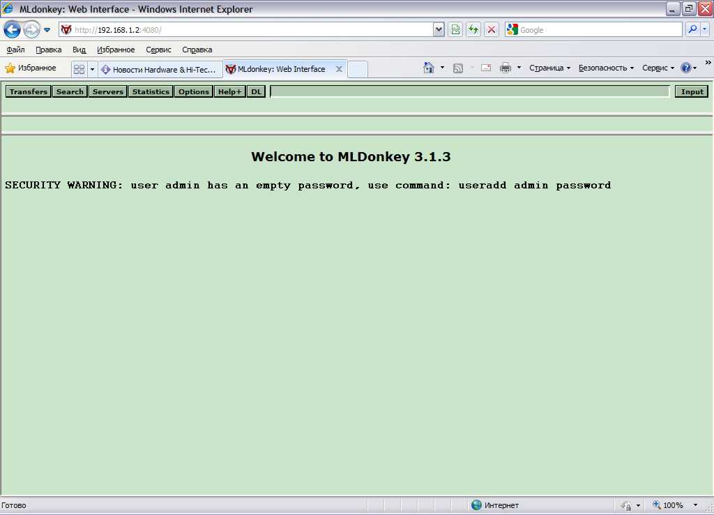

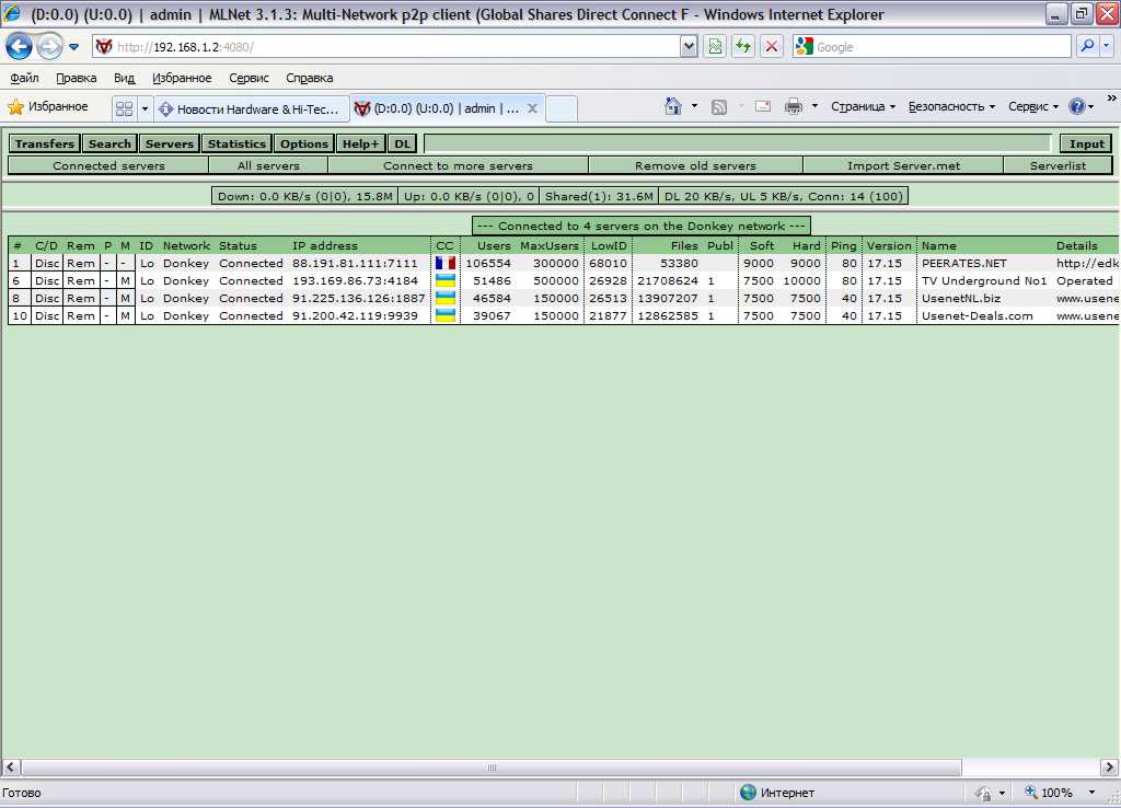

February 11, 201313 yr I've got this up and running as of today. Install the mldonkey-3.1.3 package from earlier in the thread. In addition, I had to install the following packages: gd-2.0.35-i486-4.txz fontconfig-2.9.0-i486-1.txz libmagic-4.17_4-i486-1as.tgz (I'm sure you can search the web to find these slackware packages). By default mldonkey tries to install to /root. To workaround this you have to set an environment variable MLDONKEY_DIR. I put mine in my cache directory: MLDONKEY_DIR=/mnt/cache/.mldonkey export MLDONKEY_DIR After that, you can start the mldonkey daemon using: mlnet > /dev/null 2>&1 & and access the web server with: http://tower:4080 That's as much as I've done thus far...

May 14, 201313 yr I installed the package mldonkey following the instructions of botez three posts above, and the program will start immediately. The only thing that should be done before starting the mlnet edit \\Tower\cache\.Mldonkey\downloads.ini line for allowed IP range, for me allowed_ips = ["127.0.0.1";"192.168.1.0-192.168.1.255";]
